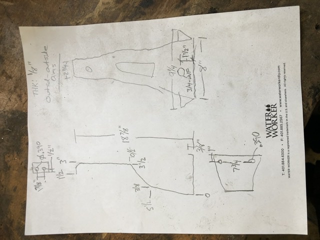

I am trying to make a early spare tire mount. Can anybody tell me the dimensions of the bracket. I'm assuming it is 1/8th thick. Thanks.

Mine is all in pieces right now, so glad to help. Which piece? The one mounted to the bed or the c-channel that spins?

I am looking for the dimensions of the piece that attaches to the bed.

I took my in-bed spare off yesterday, taking my 1968 tire up a 100 miles north to drop off for a sandblasting and new NDX. When I get back, I will shoot some pics and measure my mount and get back to you. NV

Re: Spare Tire Mount
Post by greeno »

greeno
Posts: 238
Location: Monticello, MN
Post by greeno »
Holes are center to center dims
