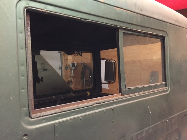

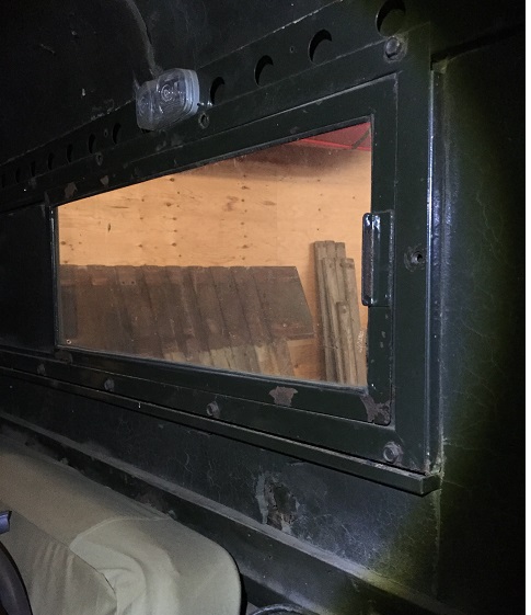

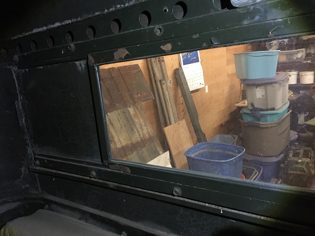

RCrombie
Posts: 164
Location: Ottawa, Canada
Re: M37 arctic cab window frame
Post by RCrombie »
Ok, Here are a few basic shots. Let me know if you need anything more specific.
Note the 2" hole ripped in the cab below the window with the riveted plate over it. Not part of the original design!
