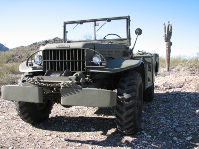

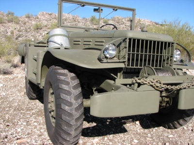

Re: Tire question
John Mc wrote:But might not be street legal in the US.Kaegi wrote:another option is the 10.50 x 16 made by STA. great looking and makes you go faster being about 38 tall
yes they are steet legal in the US
here is a set on a WC52
https://www.otrusa.com/shop/otr-tires/1 ... gKHuvD_BwE
