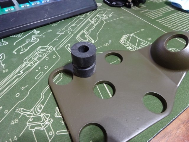

Or maybe not!! Anyone know how to put these things in the hole?
Re: installing grommets in headlight mount
soften in hot water, lube with soap or similar, and they will go in pretty easily. NV
NAM VET wrote:soften in hot water, lube with soap or similar, and they will go in pretty easily. NV
I'll try it, Thanks,

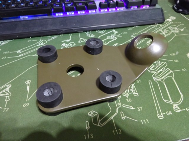

Got them in! It was not easy, but became doable after the hot water dip. My shoulders are sore from the pushing.
Nicely done!
I did all of that and a hydraulic press, easy peasy.
