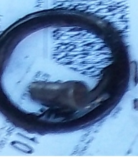

That's the weak link on the 1st-series transmission. It is supposed to be a two-stage pin that sits in the transmission shift ball groove, and flush with the outer neck. When they start wearing, the shift ball can start to turn sideways a bit before the shift ball starts to change gears. Charles at M-Series Rebuild knows the deal on these and diagnosed one of mine a few years back. I recall his shop repairs them as well but yours might be too far gone to repair. You might send him a PM. And yes, the pin replacement works from within but again, with that big bolt in place it may be too big to effect a proper repair so you might look for a new/used top cover.
The pin is inside the circle.

Hey there guys,
The shaft is assembled from below, with several parts upside down.
The 88950 is a little different from the T98 ( CDN version )
I rebuilt the 88950 using the Restoration Guide TM, with parts from MidWest Military.
( Pics and comments in another thread )
I also rebuilt a T98 using parts from Woody's 4x4 out of Washington.
( One of the few places that still has parts )
I tried welding the worn locating hole, but the casting is like white metal, so yes, you really need to find a good used one.
Charles T has a top notch repair approach, also here in a thread. ( He's my hero )
