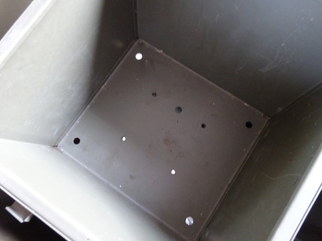

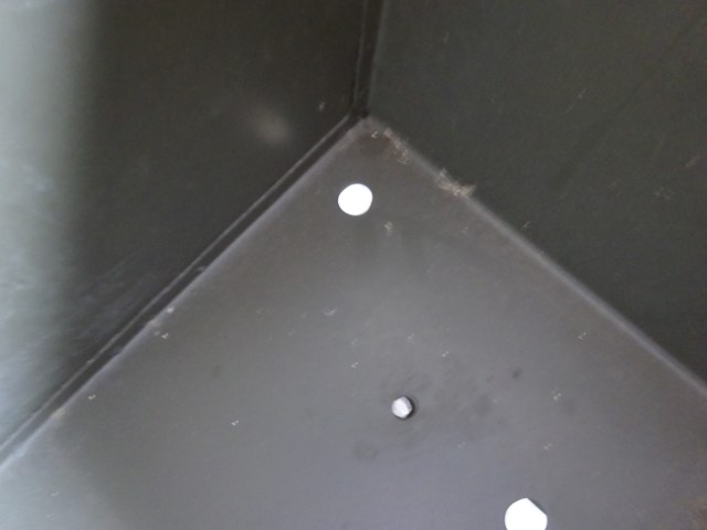

I'm getting ready to install my battery box, and wonder what to do about the 5 drain holes in the box that match 5 holes in the cab. There is about a 1/4" space between the two, are there specific gaskets that go there- maybe rubber?

The four large outer holes are for bolts that mount the box to the cab. The four small inner bolts mount the battery tray to the box. The single larger hole within the four small holes is the drain hole. The originals had a metal drain tube that was part of the battery tray and a hose was clamped on it and extended through the drain hole in the box and through the floor. Save yourself the trouble and use optima batteries instead of lead acid and you won't have a venting issue. I've been running optima batteries in my 151 since 2009 and have not had an issue with corrosion in the battery box and they outlast lead acid batteries.
Re: Battery box question
m-11 wrote:The four large outer holes are for bolts that mount the box to the cab. The four small inner bolts mount the battery tray to the box. The single larger hole within the four small holes is the drain hole. The originals had a metal drain tube that was part of the battery tray and a hose was clamped on it and extended through the drain hole in the box and through the floor. Save yourself the trouble and use optima batteries instead of lead acid and you won't have a venting issue. I've been running optima batteries in my 151 since 2009 and have not had an issue with corrosion in the battery box and they outlast lead acid batteries.
My box and tray were bolted down with the 4 inner bolts. the big outer holes are about 1/4" above the cab floor- no bolts there. Have been told that there is a rubber grommet that goes into the cab holes, and the battery box sits on them.

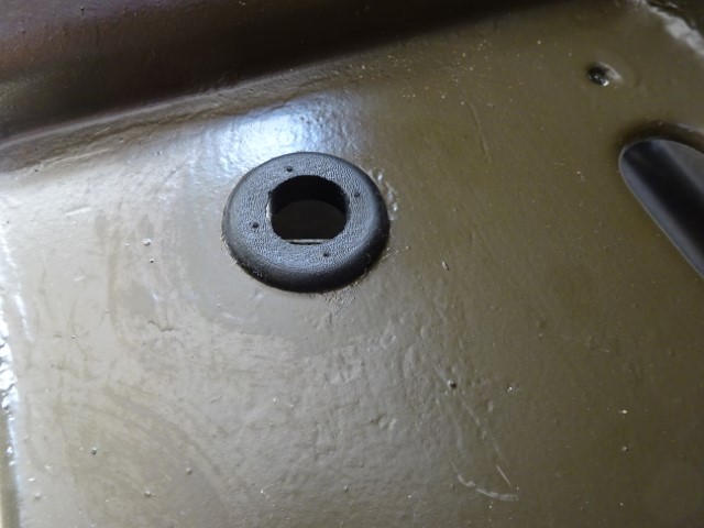

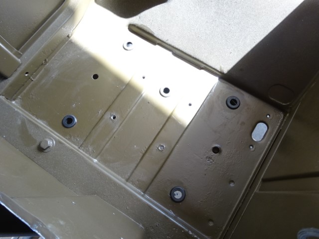

found some grommets. They fit tight to the box.

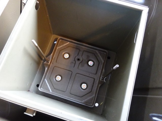

all back together.

very nice! are you going to top it off with a couple AGM battery's to preserve the beautiful job ?
