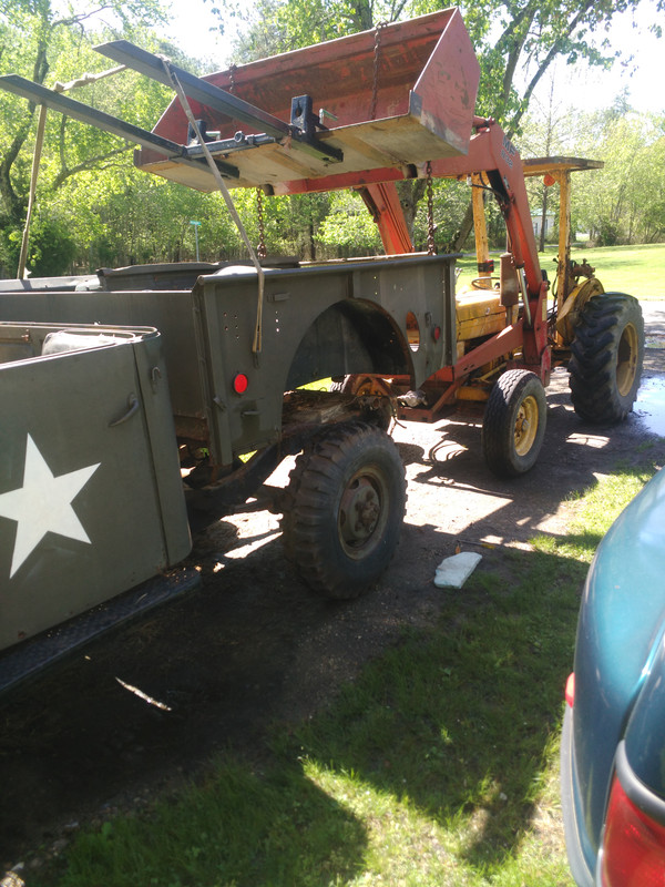

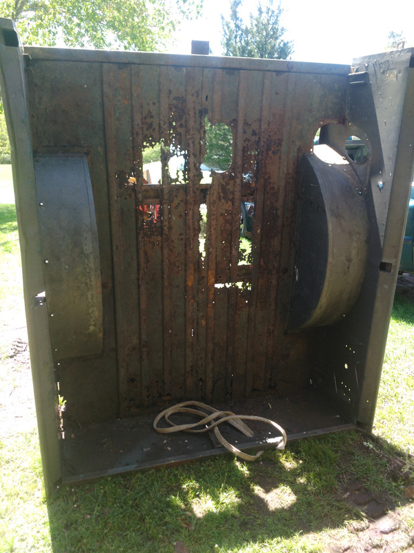

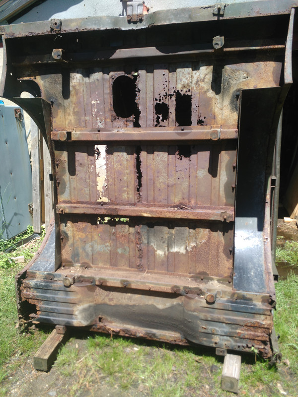

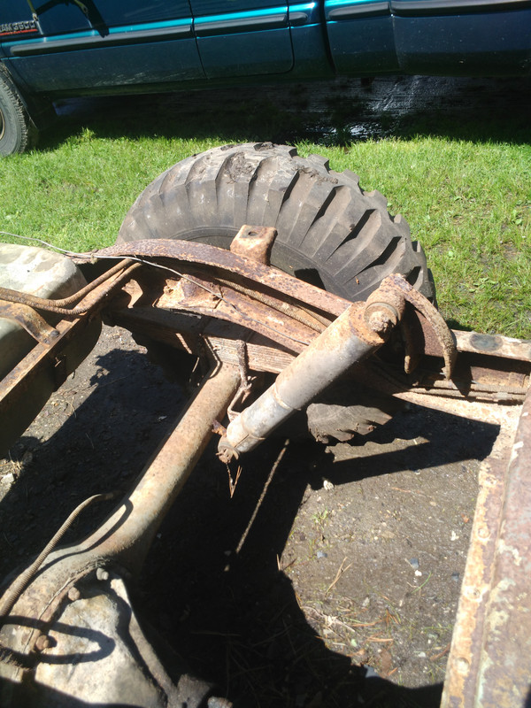

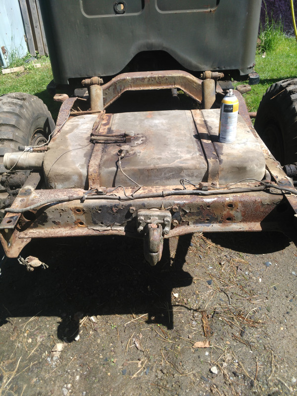

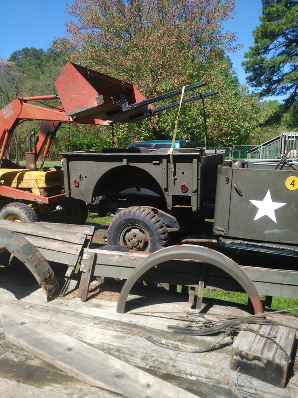

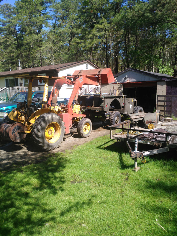

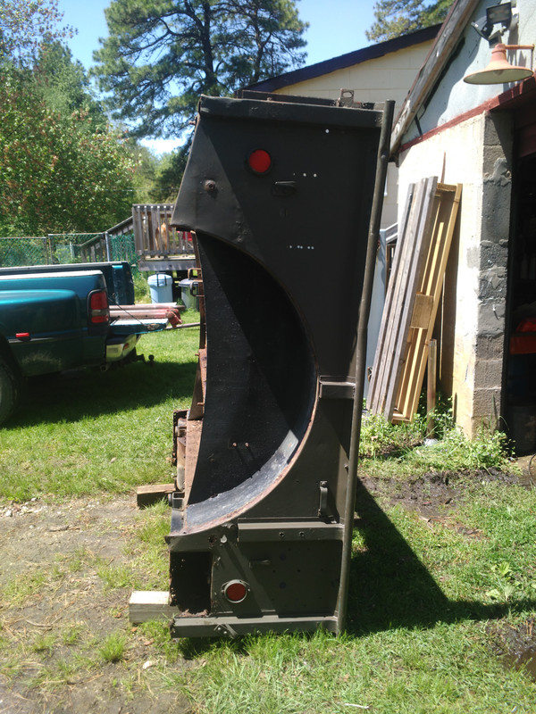

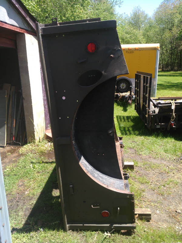

Got the bed off today. Pleasantly surprised to find the front cross member was not rusted through, it actually has flaking paint and shiny steel. Gas tank looks fairly good but I can see it is leaking under the straps. Will get that out tomorrow I hope. the bed is toast but the supports are not as bad as I thought they would be and the toolbox is more complete than I thought. Look the pictures over and let me know your thoughts.

Surprising how good a lot of that looks... considering how rotten the bed floor is. It must have been sitting with leaves or something in the back? The inner wheel arches look good too, and that’s where I have a lot of rot in my truck. I understand that the tool box rust is usually a case of condensation that tends to build up from the exhaust so is pretty typical of these trucks. What are your plans for it? Are you good with a welder?
Frame looks pretty nice in my opinion. But then, most Canadian stuff I see is rusty rusty rusty!

I have stick, MIG, TIG and torch and a wide array of body and big hammers. The frame has a lot of surface rust on it in places but no deep rust. I looks like it was painted before because I blew it off with shop air and the green paint was coming off in large flakes and leaving behind a black paint or primer. Same on the body. If you click on any of those pics a couple times it will enlarge to full size and you can get a better look.

Midwest Military has new bed floors.

WOW, your bed floor is really swiss cheese, even behind the rear wheels? Let me know if you need anymore bed stuff, ok?

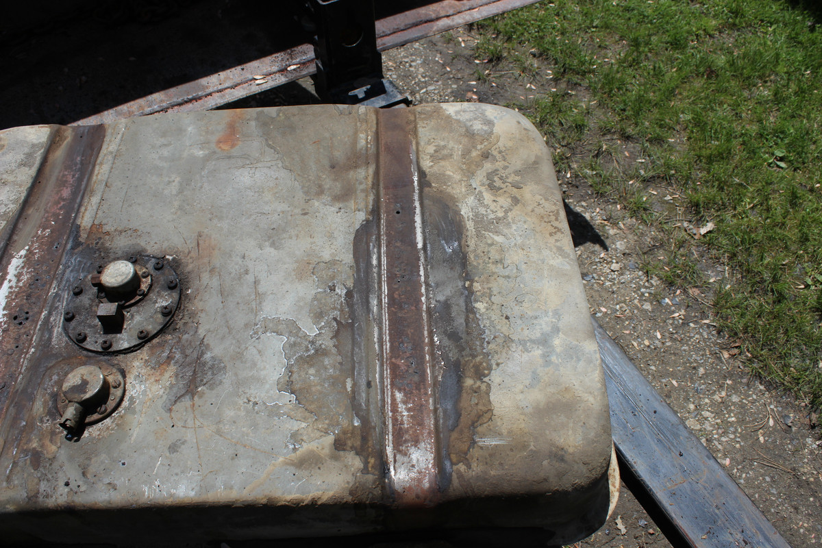

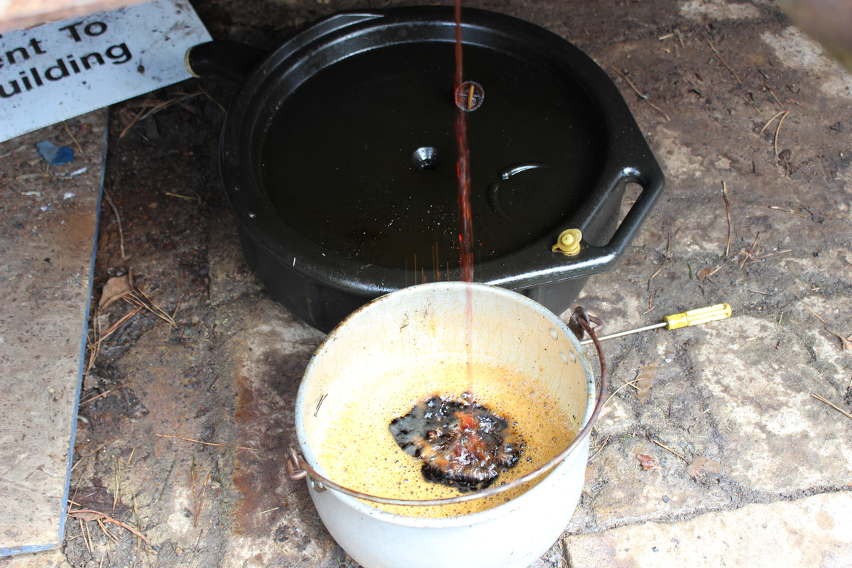

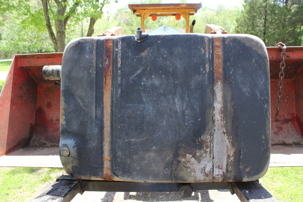

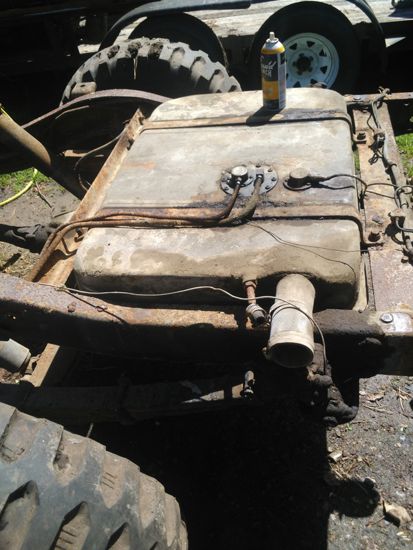

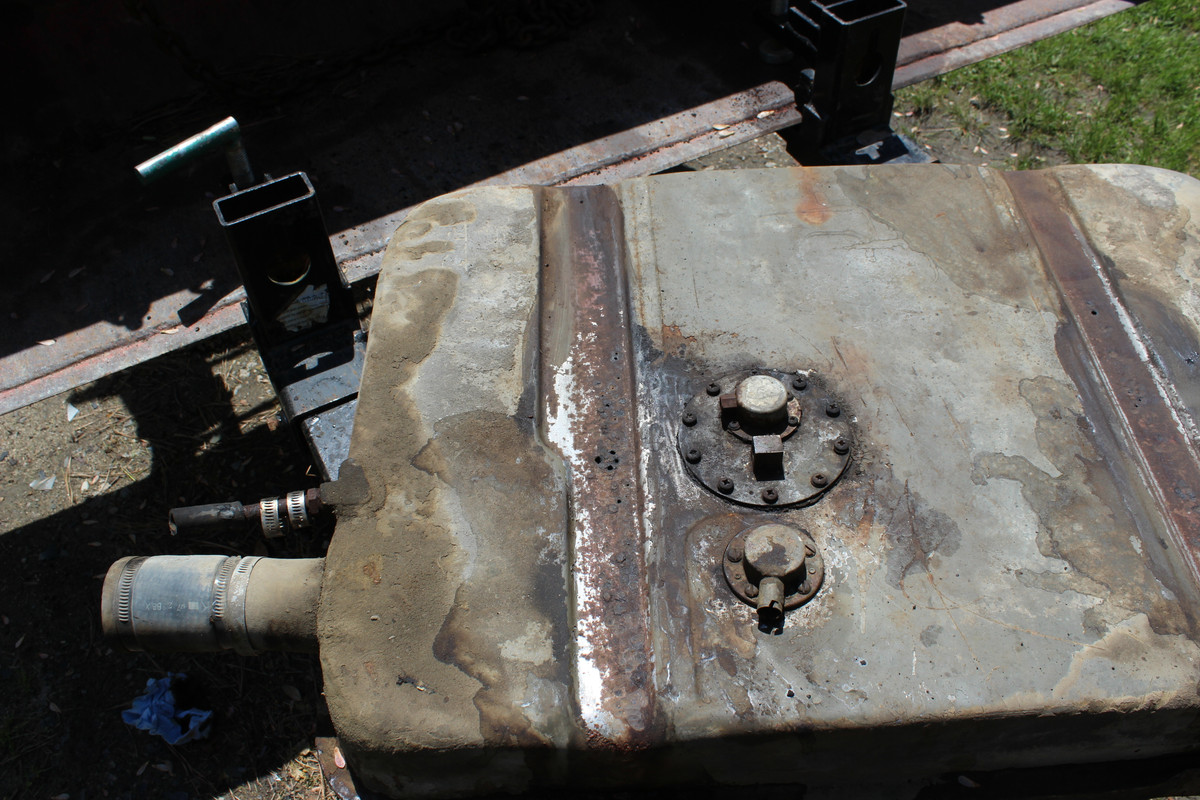

Got the gas tank out this morning and started to drain it, Yes, there is actually STILL liquid in it. Notice I said "liquid" and not gasoline. :roll: This stuff is probably at least 20 years old! I have seen some bad gas but this takes the cake. I put some in a pan and tried to light it on fire and I had to use a propane torch, Sort of like lighting diesel fuel but diesel smells a LOT better than this stuff. The tank appears to only have a couple leaks where the bands were touching it right now but I am sure once I manage to get it cleaned out I am going to find more. Two questions, One is what is the best way to clean the tank? Don't say radiator shops because where I am in NJ there are no shops that will touch a gas tank. And I am in an environmentally sensitive area and I prefer to keep it that way so I want to keep that in mind also. The other question is how do you guys usually approach taking the bed floor out? I am looking at screws that the heads are pretty much shot and I think the best thing is torch them and get new instead of fight with them.
I will put pics up this evening of the tank and nasty gas.

Sodium hydroxide will clean the tank. So will Muriatic acid. One will neutralize the other. Neither is for the ill prepared or faint of heart.
Since you want to be safe, fillit with 3 gallons of Oil Eater and 4 gallons water. Throw in a couple hundred hex nuts and lash it to a mortar mixer and spin till clean.

You can use a few 4 foot lengths of chain and some solvent, seal all of the openings up with plastic and decent tape that won't melt. Shake well, turn a few times, take a breather do it again, I'd do this for a few days, open it all up and using a flash light check it out, repeat if necessary.
BTW, My tank had a dime braised onto a hole, it's still there too. Hole repair is a hole nother story. My tank is epoxy lined now.

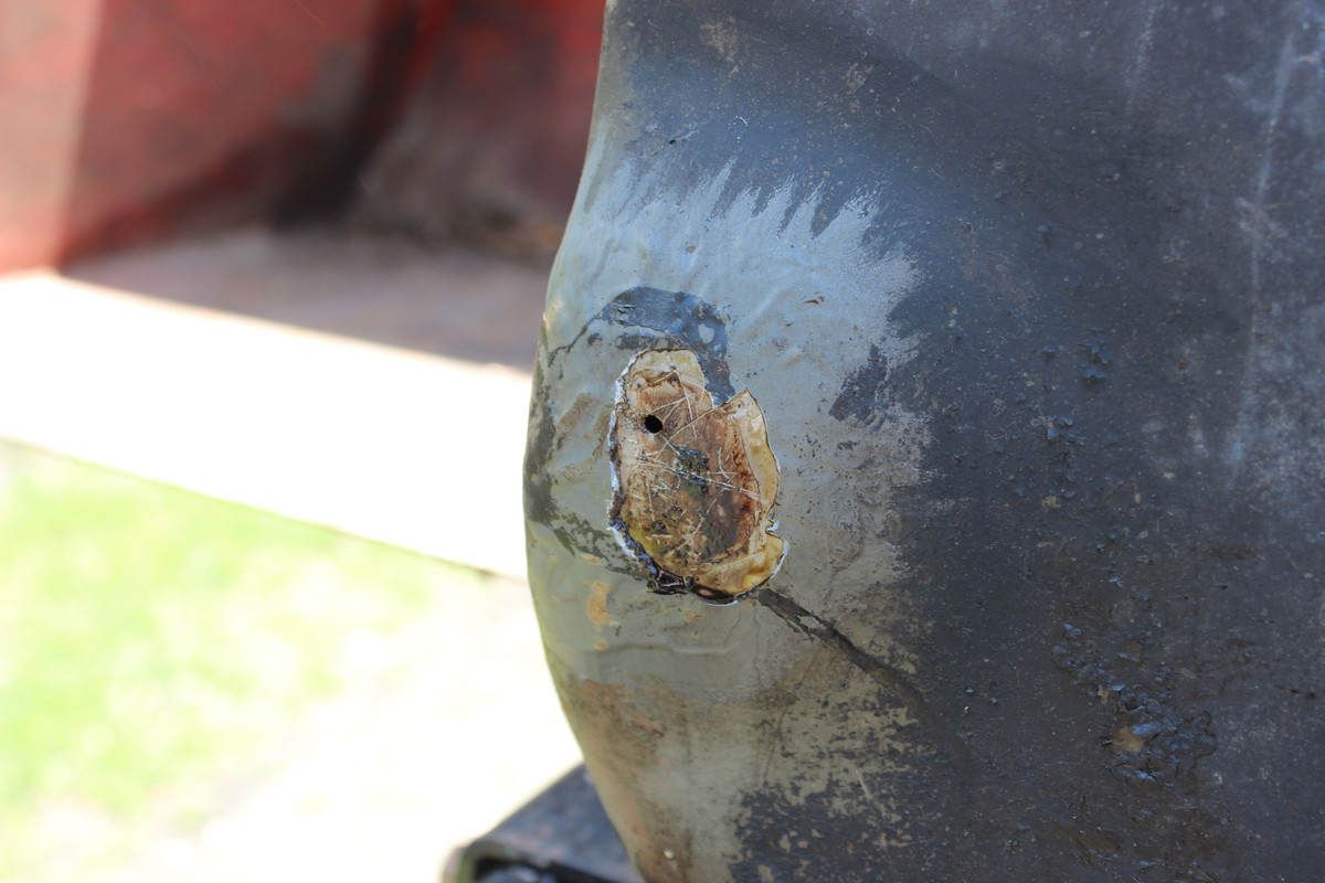

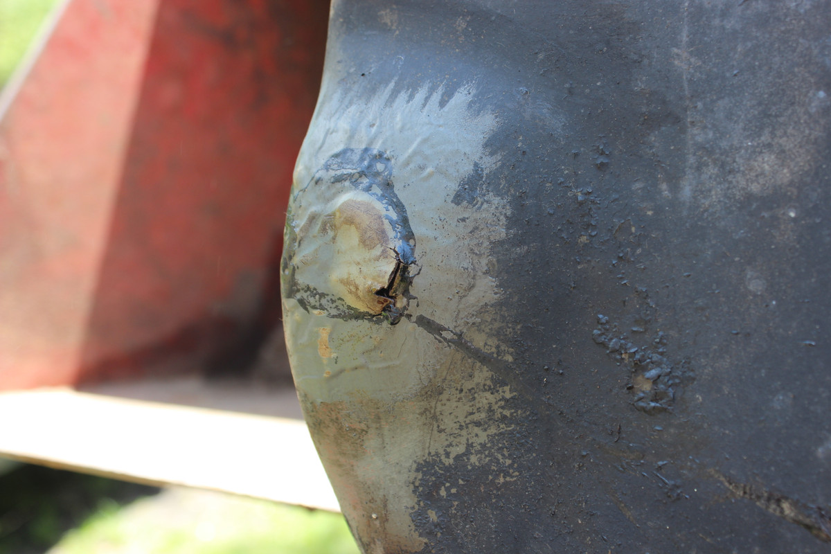

Here are some pics of the tank. I found an epoxy repair at the bottom that appears to have been covering a drilled hole. This was not really leaking until I started banging it around on the forks of my tractor. You can see some holes under the straps. I popped the top off of it and there is a 1/4" layer of gunk in there that is probably mostly rust from the top side of the tanks but under the gunk which actually breaks up quite easily is nice shiny steel. So is looks like at least most of the bottom of the tank is good. I put the top back on to keep it moist until I can get in there and scrape out the worst of it. MAN this stuff STINKS!!!!!!!!

I've never seen such a collage of photos, Rick-thanks for such detailed shots! No telling what was poured into the tank over time. You'll likely have to torch or air-chisel the bed bolts-not worth fussing over, trying to free them up-I think there is something like 64 of them and would take a ton of time to retain serviceability.
