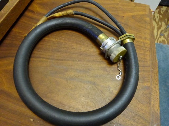

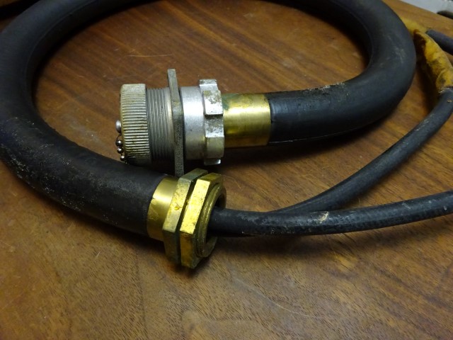

My truck has the holes where there were plugs and wiring between the cab and the bed. I would like to re install them, but have never seen the stuff. Pics would be great, diagrams would be good too.

I think this is what you're looking for?
(These images are from an eBay listing last year by battlewagons; maybe he still has it?)
The plug and plate at the cargo box front wall has some small parts, and they're hard to identify from the ORD 9 SNL.
I believe that John at Midwest Military still has this assembly, or at least part of it, available.
If my memory is right, keep in mind that there's no switch or circuit breaker on the radio power feed, so that plug in the box is always live as long as the batteries are connected.

Thanks for the photos, just what I was looking for.

Here is what I got from MWM! He doesn't have any of the other pieces.
- DSC01039 (Small).JPG (111 KiB) Viewed 1174 times
- DSC01038 (Small).JPG (117.02 KiB) Viewed 1174 times
