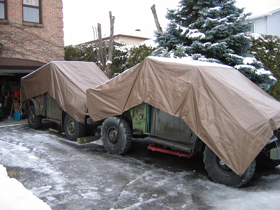

- Winter storage for the Ms
- IMG_260225.jpg (140.74 KiB) Viewed 946 times
