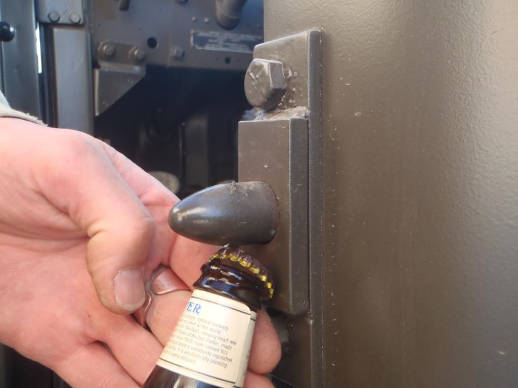

This truck I just purchased has the nuts and bolts in front of the driver's door hinges and has a very large pin on the quarter panel beside the door handle area (no brackets or rim attached).

the catch pin for the spare tire carrier works well as a bottle opener
