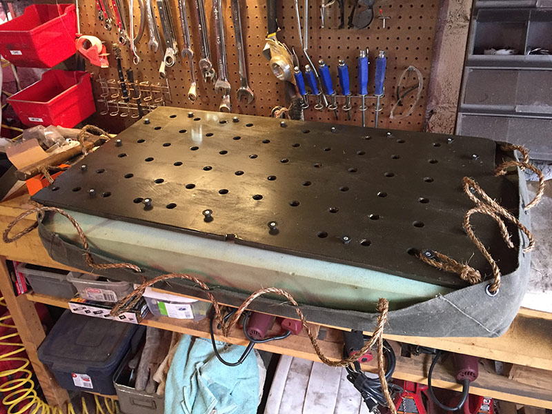

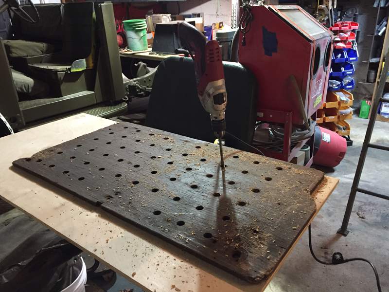

Having gone down the same path here I'll throw in my two cents. I went to Lowes and looked in their specialty parts section where the hardware is. For the bobbins I discovered washered nuts. They look almost identical and will serve the purpose well. Of course they didn't have the quantity I needed so I made note of the size, 1/4 20. A little googling and I found the metric equivalent to be M6-1.0.
https://www.dormanproducts.com/p-8373-700-270.aspx
I was able to find them on Amazon. A box of 25 was $15.57.
https://www.amazon.com/gp/product/B0033 ... S690VEVQYI
My wood was in OK shape, but since I overdid it on everything else I figured why stop here. I picked up some 1/2" birch wood, took the old board and screwed it to the new one so it wouldn't move. Then I used the existing holes as a pilot to guide my drill bit to drill the new ones. I traced the shape of the board and then used a reciprocating saw to cut out the shape. It looked like I used a pair of kid's scissors because the blade kept bending, so in hind sight I should have used a router. A little sanding and it evened out.

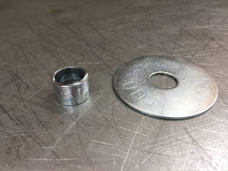

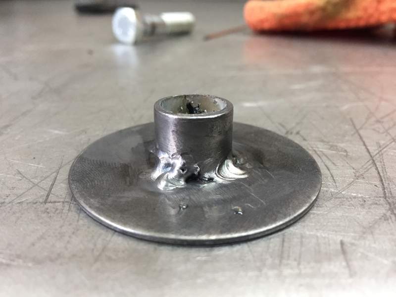

For the holes that the metal dowel goes through I took a 2" washer and a metal spacer and TIG welded them together. The metal spacer was 1" long so I cut it in half to get the two 1/2" pieces I needed.
All I need to do at this point is order the latch mechanism from Vintage and paint it 24087. Then on to the driver's seat!
As a funny side note I had no idea what those bobbins were even before until I got to this thread! Thanks to w30bob for posting the pics.

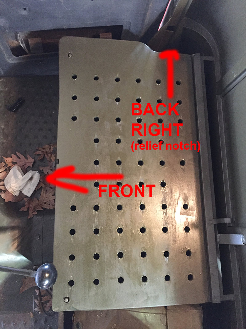

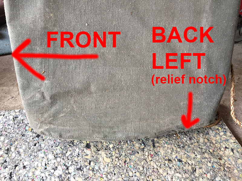

OK I'm stumped and have a question. So I finally got all the hardware needed to put the bench seat bottom together. After successfully lacing up the 1/4" rope and really prying the crap out of the canvas to stretch over the wood it was done, but then I realized that the relief notch in the wood did not correspond to where the relief notch in the canvas was. There was considerable strain on the fabric which made me think it would eventually rip so I took it apart.
Here's the way I had it laced up prior to pulling it tight:
There you can kind of see the two indentations on the right, and that they are not lined up. It would seem that the indentation in the fabric should match up to the indentation in the wood.
I started flipping the wood around trying to figure out if I had the orientation wrong. Then I thought maybe the fabric was inside out, but that's not the case because then the seam would be showing. I took a step back and started with just the wood. Is the orientation here correct?
If that's correct (which I think it is), then why does it not line up to the fabric?
Am I missing something here? I can't seem to find any illustrations in the TM's about it. They reference the seats but only in text. I went to take a look at another truck but the guy didn't have the heavy canvas material with grommets, just a lighter fabric stapled to the wood so it was hard to pull any info from it. His wood was oriented the same as mine.
Any more pics or ideas you guys might have would really help. I am kind of at a standstill here. Thanks!

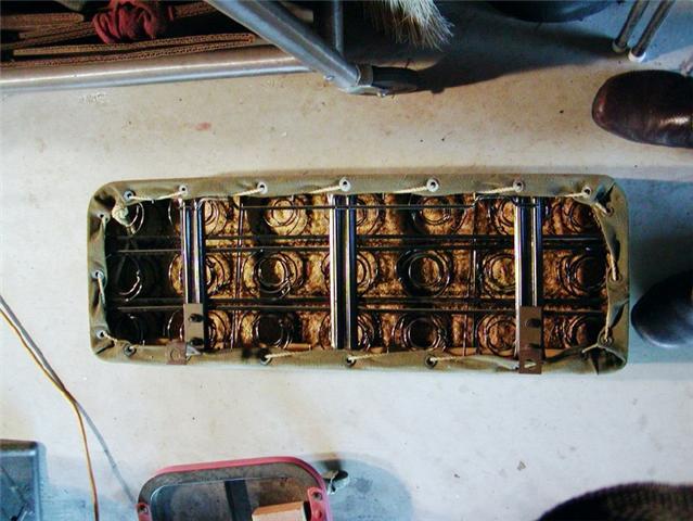

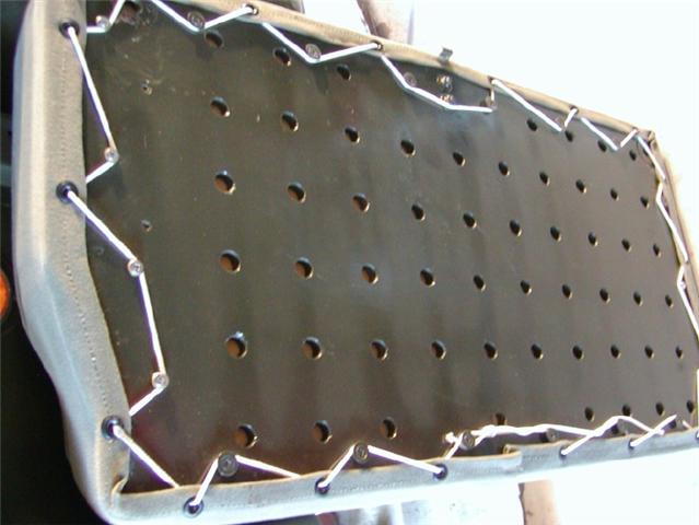

I looked around for my pics, mia so far.
- m-37passbase1.jpg (35.15 KiB) Viewed 3239 times
Re: Need photos, driver's seat cover install
Passenger side back
- m37passback1.jpg (53.05 KiB) Viewed 3239 times
Yah see yours fits just fine, the fabric is in the correct position to meet the notch. Maybe I have the wrong fabric? Dang, I was hoping to not have to buy this again. Thanks for posting Bruce.
