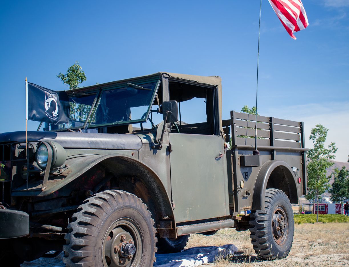

[quote="outsider"]Bob, My M37 is painted is Gillespie's semi-gloss od. Which I believe is the color you are referring to. You can see a picture of it in the registry.
what color is this one?.: It's not the same as above. I believe this is the color I have under my paint. 1962 M37
Posts: 4368
Re: Picking the "Correct" Paint - Help Needed
So a few things:
w30bob hasn't been on line since 2017 (if you are logged in you can click any user name to see when they were last on line). Since this post is so old and Bob hasn't been on line you'll likely not be receiving a response;
I think Hal was referencing the Nam-era Gillespie 24087 shade in his post;
And Ronnie, the lower photo you posted looks to me like the earlier Gillespie 23050 that was used pre-Nam.
Mine is Gillespie 24087-look at the bed in my photo from eBay Summer Nights 2018 (the Crawlers and Haulers trophy winner) :)
