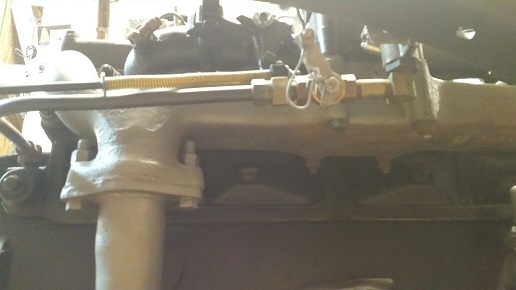

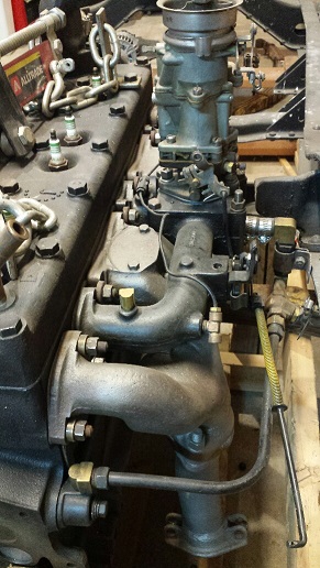

I have some up close pictures of the intake on my L head, I've noticed in some pictures of other builds that there is no plumbing like I have on mine. I think this extra plumbing is for cold weather starts. what do you all think?
I found my spec sheet for this engine and I'm going to have to phone my engine builder to clear up the details but hear is the part number used for the pistons... E279 ? Hope that says something... I will get back to this after my engine builder help me understand a few things.

Yes, your intake manifold appears to have the small diameter tubing and fittings for the engine priming system, although the connection from the "T" nozzle at the Nos. 5 and 6 intake manifold port to the pump in the cab is either missing or not visible. Or is the engine not yet installed in the frame?
The larger tube from the back of the cylinder block under the exhaust manifold, through the fording valve, and into the intake manifold is the crankcase breather, although it's routed outside of the exhaust manifold instead of the usual arrangement between the manifold and the block. Maybe the 251s are plumbed differently?

Elwood wrote: although the connection from the "T" nozzle at the Nos. 5 and 6 intake manifold port to the pump in the cab is either missing or not visible. Or is the engine not yet installed in the frame?
Yes, the engine is not in the frame yet, when I bought the truck it was missing parts, like 24V Dist, wires and plugs, air cleaner, generator, and obviously more stuff as I go... :( . My decision to keep the original engine vs say a modern 318 is turning out to be harder then I thought. But going for a working show piece is the ultimate goal.
So this priming system must be tied into the fuel system some how, I would think that it would come from some where at the fuel pump. The fording valve must tied into the chock when starting the engine.. If anyone has pictures of there Intake system to compare to .. would much appriecated :D
I have a copy of the instruction sheet and kit contents, and can send those to you if you PM me your email address.
Here's what's in the kit. There are two different installation schematics, depending on whether or not your truck has the early production fuel filter mounted on the voltage regulator bracket. In either case, the priming system uses a hand pump mounted on the dash to the left of the steering column, and draws fuel from the supply line on the left frame rail, before it reaches the mechanical fuel pump on the engine block.
The fording system uses a separate knob on the dash (between the throttle control above and the choke below) with two cables to control the two fording valves. It is not tied into the choke. There are some good photos in the photo albums of the set up - the search function should find them.
