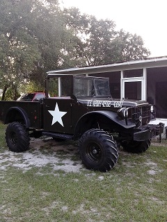

I am trying to get the top put together for my 53. There are 2 poles the top bow should slide into, but the poles and bow are the same size. Are there couplings that attach the 4 pieces together? Can anyone post a pic of how it works? The manual does not address this. Thanks!
PS I've enclosed a pic of my truck.
