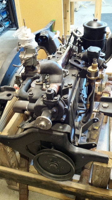

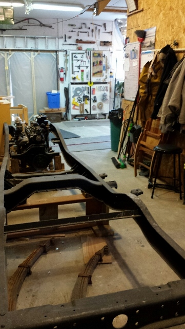

Here the project sits and waits for the axles, you can see the transfer case in background with the tranny on the right. the springs are redone +2". The frame sandblasted and Ind. primer at a Mining Equipment rebuild shop. And I have two more pics I just downed off my phone... too cool.

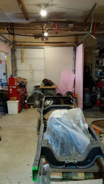

The 251+ is stored backwards in the frame, The rest of the truck is out the barn doors under a buried lean-too :lol:

WHEN I find the spec card for the this engine ... I will share the details.. I know one thing this 251 felt at home in this engine shop opened in 1954... and he had parts on the self. He sourced out pistons due to milling etc.. so maybe our right RMS.
