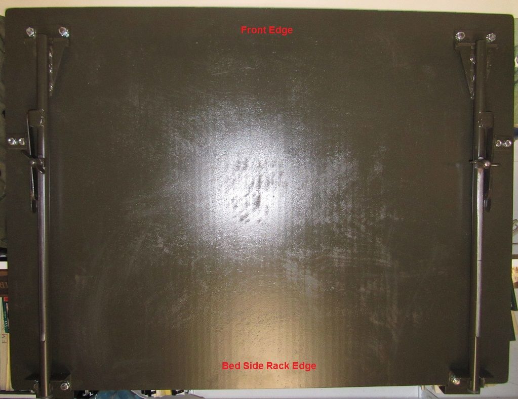

The first photo is of the table as a whole. The picture is of the bottom side so you can see the legs.

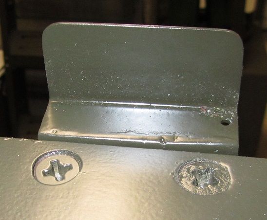

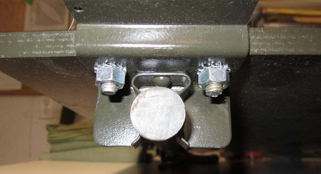

The next picture is of the flange that holds the table to the side racks of the truck when it is set up in the bed. This bracket also holds the legs to the table top when the table legs are collapsed.
The next two pictures are also of the same bracket, but viewed from the underside of the table when the collapsed legs are captured by the brackets.

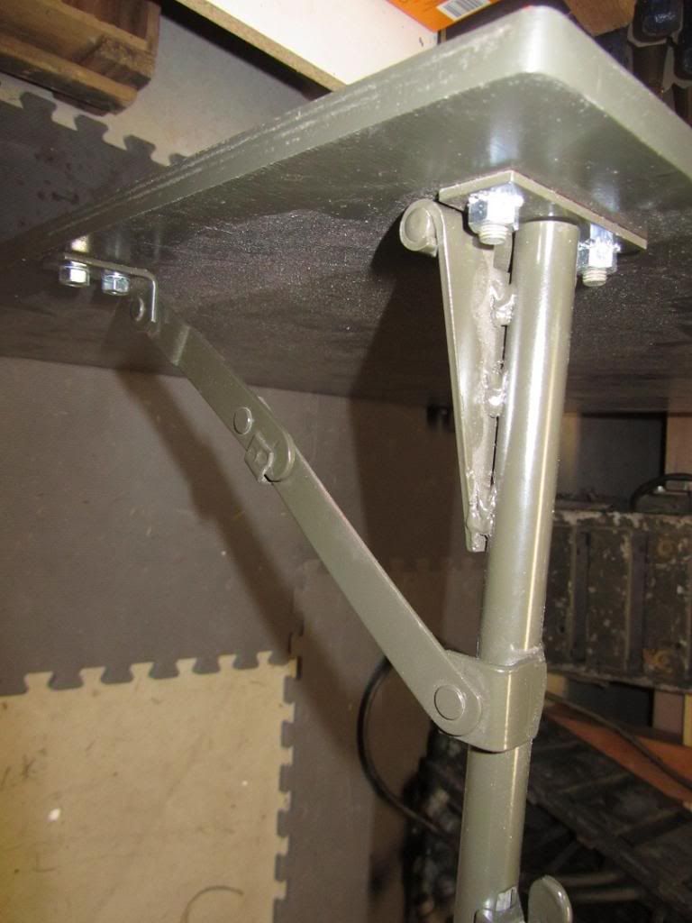

The next photo is of the top of the leg assembly showing the hinge which is at the front edge of the table.
The next photos are of the legs extended. It shows the hinge and the locking mechanism for keeping the leg rigid.

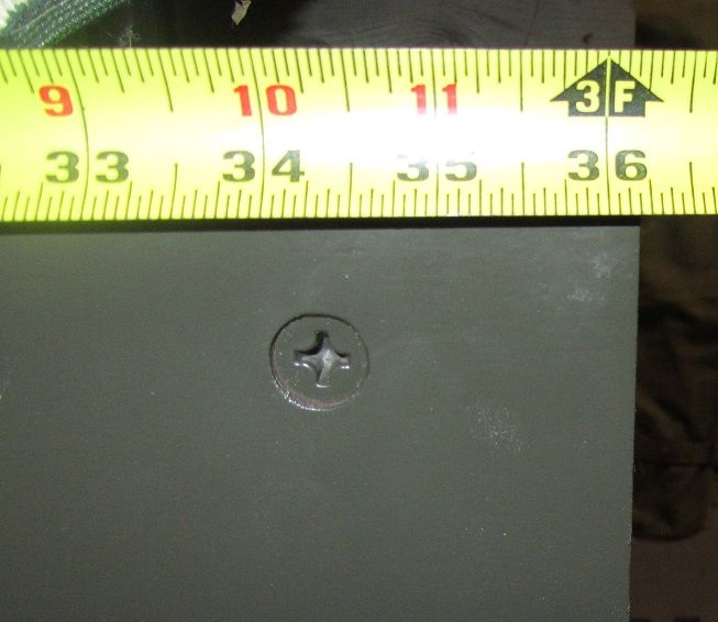

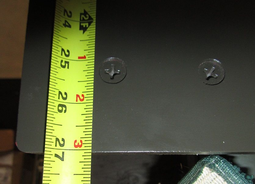

Here are a couple of pictures showing the width of the table (side to side) and front to back. These dimensions are not critical. The thickness is 1/2 inch.
I'm sorry, but I just can't dimension all the parts for this table. It would take a serious amount of time to do a drawing and spec all the parts.
John at Midwest Military is the best source I know of to help you with these tables.
Here is the width of the table.
Here is the depth (front to back) of the table.
