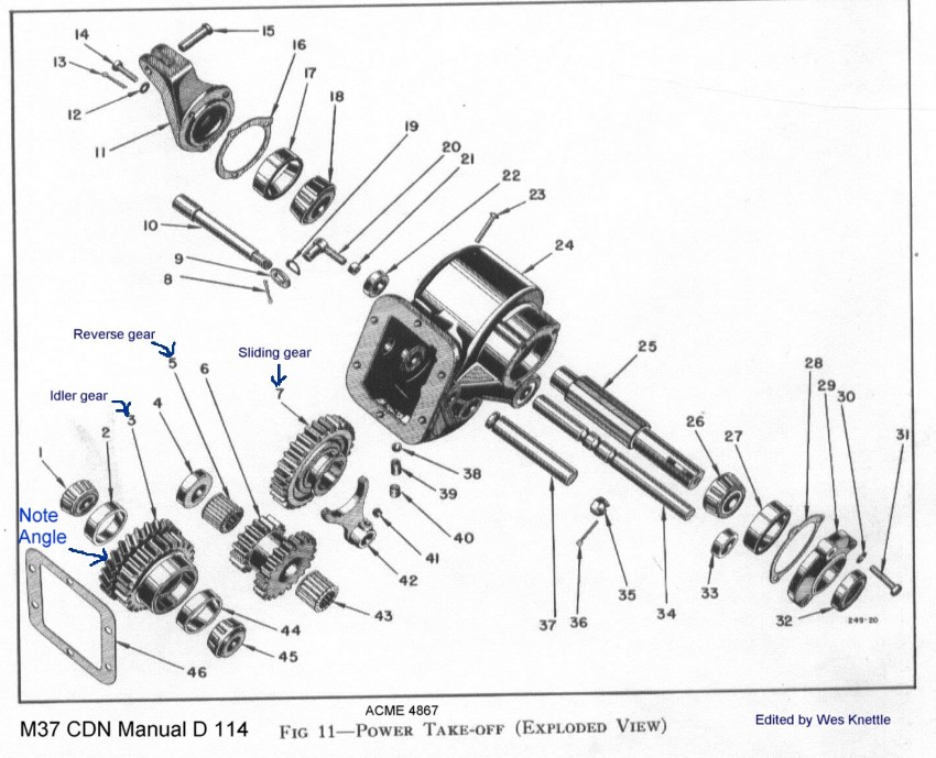

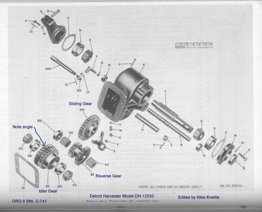

So just to be sure that I understand this, if I get my hands on a US PTO and change out the idler gear with the other version from VPW (does anyone know what the part number is?) then the pto will work on my Acme Canadian trans? Is there truth to clearance issue around the oil pan on the Canadian 251 that I mentioned above.
fig 20-1 sm.JPG (143.3 KiB) Viewed 1392 times
US PTO

Canadian ACME PTO
MSeriesRebuild

dotgain wrote:So just to be sure that I understand this, if I get my hands on a US PTO and change out the idler gear with the other version from VPW (does anyone know what the part number is?) then the pto will work on my Acme Canadian trans? Is there truth to clearance issue around the oil pan on the Canadian 251 that I mentioned above.
Thanks for all your help!
Paul.
A US pto with the idler gear change will do what you need.

I had a look at my motor and really can not see how there would be an issue with the oil pan.
Also pulled the pto plate off my trans and can confirm the angle of the teeth are like the illustrations posted above.
This should make my pto search easier.
