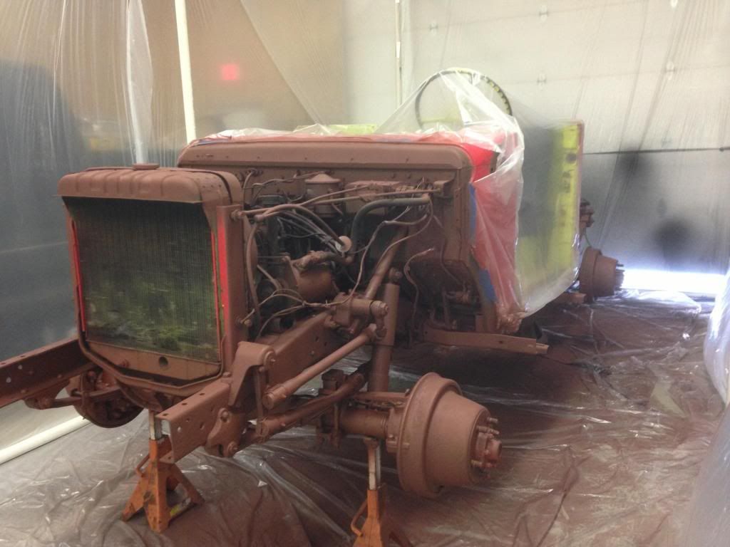

Tuko
Posts: 380
Location: CT
Re: New member hello and some questions!
Post by Tuko »
got the front of the truck put back together will be waiting for the spring to work on the bed, rims etc Image
Looking good Tuko.
