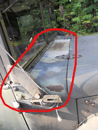

Hello All,
I am looking for a good upper cowl the part with the dash, windshield mount and vent something worth spot welding into my cab or at least good pieces that I can use for patch panels, I'm tired of sending folks money and getting scrap metal in return so please no garbage

We are building an M37 that had severe rust through damage in the area. What we did was cut it out back into good metal, cut out an appropriate parch panel from new 16 gage metal, cut the hole for the vent, shrink and stretch angles to build the vent weather-strip trough and water drain trough; welded all that in place, then welded the new panel in the cowl. Time consuming, yes indeed, but we have a repair that is very solid and good as new if not better.

Thank You for the reply, The vent weather strip an surrounding area is what I need to replace and also the cowl corners, I've been kind of hopeful that I would find a clean cowl but the panel on my cab is actually in better shape than the replacements I've been getting, It's too bad no one produces a full replacement skin
