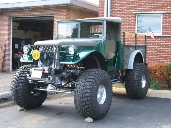

Having said that. I have been looking at a couple of chassis . 80's Blazer is a little short and short bed pick ups are a little long so either way you are gonna have to cut the frame. I haven't really looked at witdths yet . I have been thinking it would be fun to put an M body on a modern frame.
This picture got me thinking about it. I think the one used in this pic is a Blazer .

Re: Any info. on chassis swaps?
The chassis doesn't make the size of the engine bay - the sheetmetal wrapped around it does. Any engine will fit between the rails and under the hood with enough thought given to the process. I've got a 428 Cobra Jet under my hood, and Josh has a twin turbo Dodge 400 under the hood of his. Both of us are running 1 ton driveline under the original frame rails. Virtually any V8 will fit with out too much fuss. About the only engine thats a real pain to install would be a Cummins 6bt due to the length. But that would require cutting the sheet metal out of the firewall, not changing the chassis.
WMS to WMS an M37 is 72" wide. The wheelbase is about 114".
A standard GM Dana 60 front with single wheel hubs is 69" wide. A corporate 14bolt rear is 67" wide. A dana 60 with the dually wheel hub is 78" wide, while a Dually C14 rear is 72" wide.
As for a chassis to swap under an M37 body, a fullsize jimmy or blazer is about 106", a toyota truck (regular cab s/b) is 112". Most fullsize S/b trucks are around 118" depending on year and manufacturer. Long box trucks are usually at 125" or longer. The wheel base of an IH scout travellall might be close, but I don't know what it is. Even if it was close, it would be a down grade in the strength department. None of the newer trucks (pre - 2000) have a chassis that is really any stronger that what is under the M37 to start with. Plus swapping it over just adds more work as the engine bay size is still goverened by the sheetmetal, and now you need to build 13 body mounts, instead of two engine mounts, a tranny mount, and some suspension mounts.
IMO you'll be miles ahead and less frustrated by just using the M37 frame.
Hope this helps.
