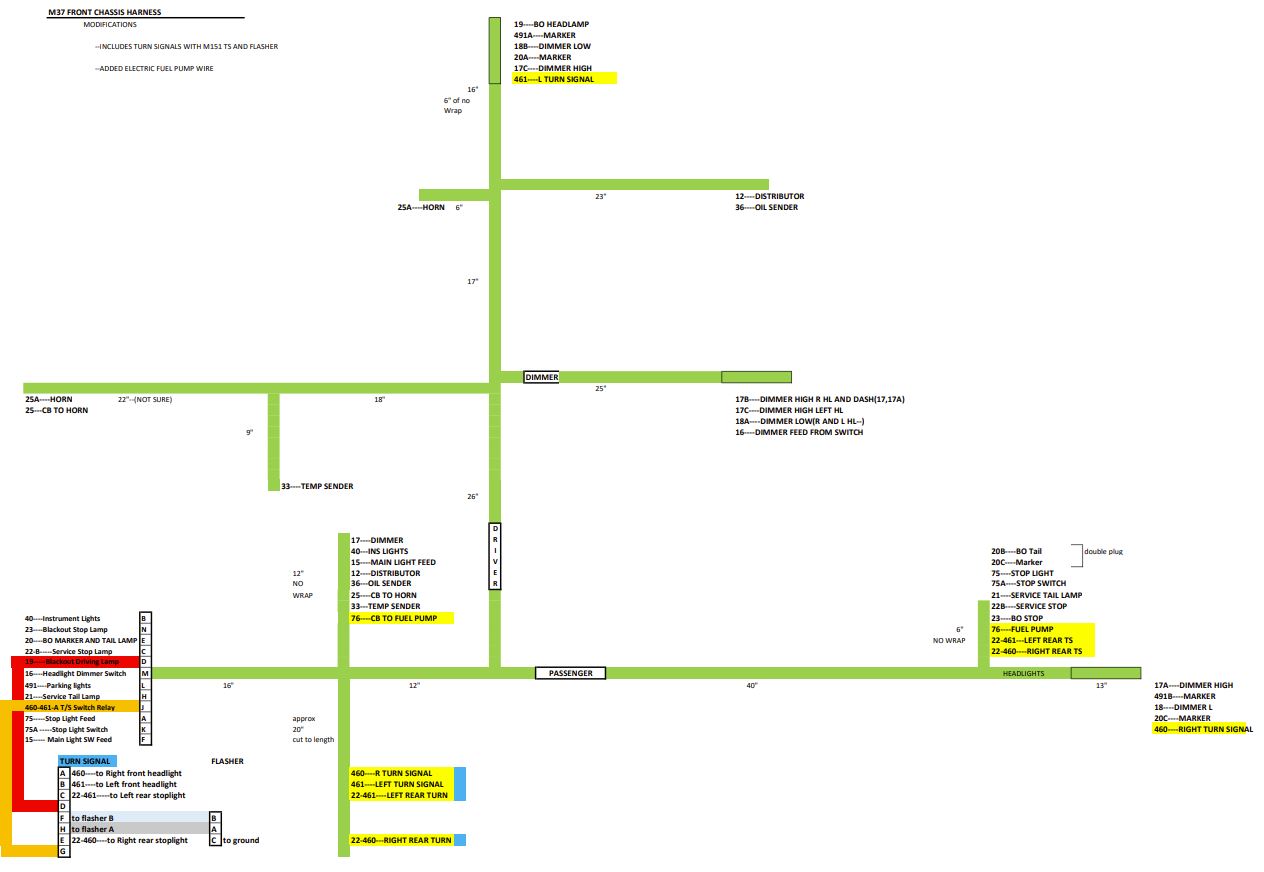

Re: Main Cab Wiring Harness
I worked through the old harness I have over the weekend and came up with a schematic. I added the wiring for turn signals and an electric fuel pump. Feel free to let me know if you see any errors. I plan on starting to build it up this evening and would rather catch any problems before I start the wrap.
