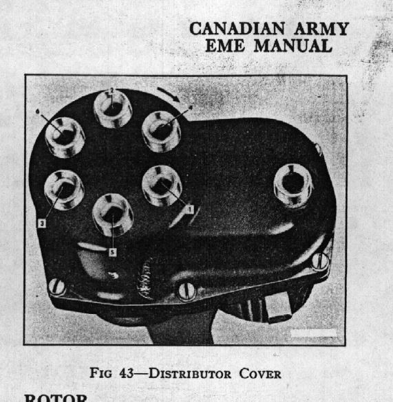

Been trying to time my 230 Cu In and just cannot get it right. Pulled distributor cap at #1 on TDC Compression stroke and the rotor points to about the 5 o'clock position. # 1 plug wire goes to the corresponding tower on the cap as the rotor points to. I have read somewhere else where you remove the oil pump rotate the distributor drive gear counter-clockwise by one tooth and reinstall until distributor points to the 7 o'clock position on #1 TDC Comp stroke.
As it is right now I cannot adjust the distributor enough to get to the right setting of 2 before TDC- 6 after TDC. Distributor hits the adjusting bolt on the adjusting plate.
All of this because it cranks and runs fine until 4th gear and is flat on power then Revs fine, just no power on small inclines. Carburetor has been cleaned and points and coil test appropriately.

7 oclock is the correct spot for number 1. do you have the distributor and wires in the correct orientation? did someone move the wires into the wrong spots on the cap?

Yes, the distributor is oriented correctly. Yes, the wires have all been moved one position counter-clockwise in the distributor. Rotor points to 5 o'clock currently. That is my reasoning for the oil pump gear to be off by one tooth. Not the offset slot in the end of the pump shaft.

I had the same problem - couldn't get the timing right. it's a six cylinder 4 stroke engine, which travels 2 revolutions before #1 fires again. 2 revs is 720 degrees divided by 6 cylinders = 120 deg of crank rotation per firing pulse. The distributor runs by camshaft gear at half speed of the crank, so it only travels 60 degrees for each firing pulse.
There is not quite enough room to swing the distributor the full 60 degrees to get the timing right if it is timed wrong to the camshaft (through the oil pump gear drive)
Fix it
1. Put the #1 cylinder on TDC (top dead center).
There's a 1/8 inch pipe plug in #6 cylinder for probing TDC. #1 and #6 pistons travel together, so if 6 is up, so is 1. If compression pressure is coming out of the #6 1/8 pipe plug hole, then turn the engine one more turn to get #1 on TDC compression stroke.
2. Now unbolt the oil pump, slide it out and turn the gear and reinstall so that rotor button points to 7 o'clock. Ensure offset tangs match.
3. Now turn distributor to middle of coarse and fine travel range. Install cap, find plug hole @ 7 oclock on the distributor and you'll put #1 plug wire here and install the rest of the wires 153624 in order. When bolting oil pump back to block, watch for broken gasket or replace it.

Well, I finally got around to getting my timing right. I could not have done it without the help from this group. With #1 cylinder at TDC on compression stroke, my rotor was pointing to the 5 o'clock position in the distributor. I could not get enough adjustment by moving the distributor to get anywhere near 2 BTDC of timing.
I followed your suggestions and removed the oil pump and turned the geared shaft one tooth counterclockwise and replaced it while turning the distributor rotor to the 7 o'clock position. Reassembled everything, put the timing light to it and got it adjusted to the 2 BTDC. New plug wires also helped ($300 from VPW) it to run properly I feel. Before it was somewhat sluggish and now it seems to be a more smooth even acceleration to my top speed of about 43 mph. By the way it has a rebuild Depot tag on the motor from 1970. I can only guess it was assembled back then with the timing off from the Depot.
