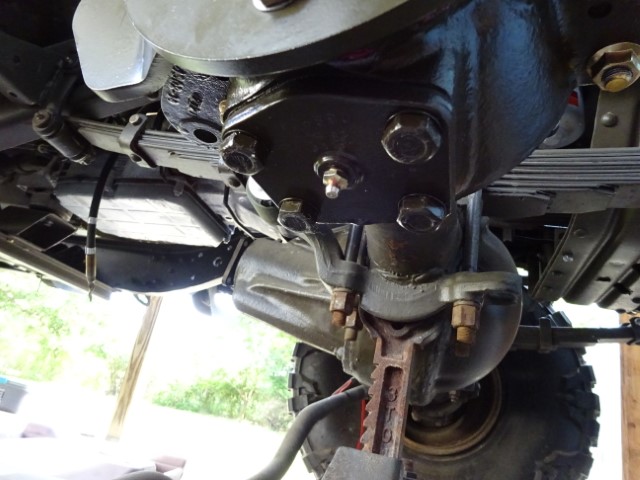

The lower part of the half-cone (for lack of a better word) has a slotted-head plug that's removed when greasing the upper zerks. You know it's full when grease starts coming out the hole (and remember to reinstall the plug afterward).

here it is, took almost a whole tube of grease to fill both sides. Thanks for the suggestions on where to look. NV

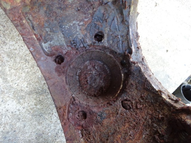

This is what I found when I opened up my knuckles--they were full of grease, but not at the bottom. The bearings were completly rusted up.
So, I put in a grease fitting so that I could flush the bottom bearing. A NPT plug might work, but I prefer to fill the bearings with new clean grease, not pumping the old dirty grease thru them.
