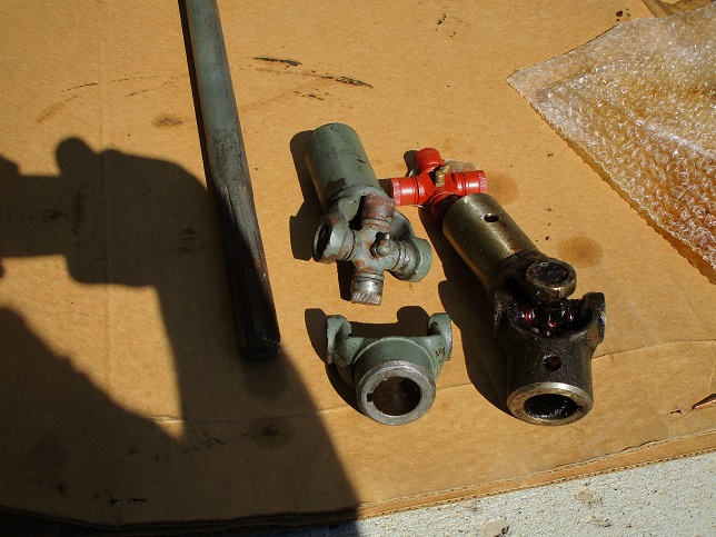

I should be able to post some Friday afternoon, UTTAS, as my PTO shaft is out of the truck right now.
Posts: 4368
Re: PTO drive shaft pictures

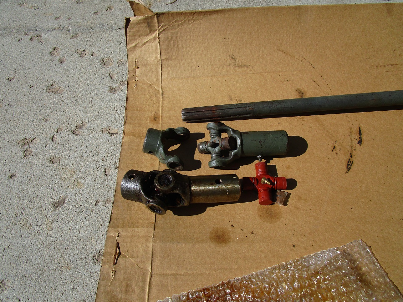

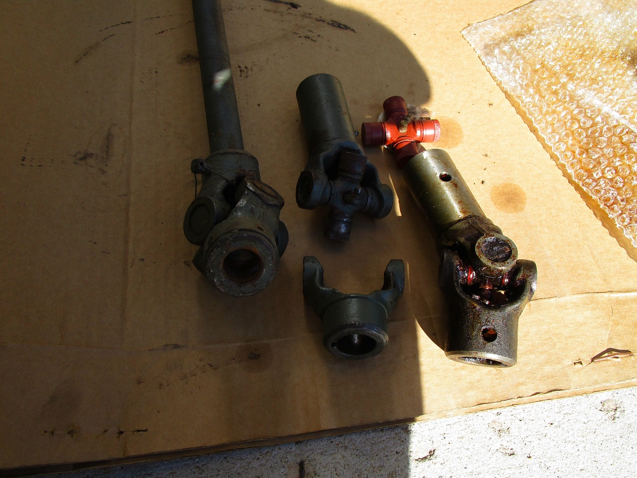

Sorry-a little late but these should help. The top photo has the winch end of the shaft in view. I reversed it in the other two.
As you can see, I need to replace the U-Joint in the PTO end of the shaft; you also see an NOS end shaft still in Cosmoline next to it, and a replacement NOS U-joint in red primer as well.

Cal_Gary, thank you so much for the pictures!! It appears I do have both ends. I'll do some investigating today.
