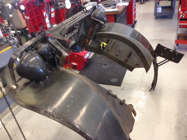

I read the US Dodge books and was interested in the changes they suggested for the WC's design that carried over to the M37. I give the designers credit, the removal of the grill and fenders is pretty slick!
No Nose.JPG (127.42 KiB) Viewed 1414 times
They really did a nice job of packaging and simplifying hardware. Wish this was more common in designs these days.
