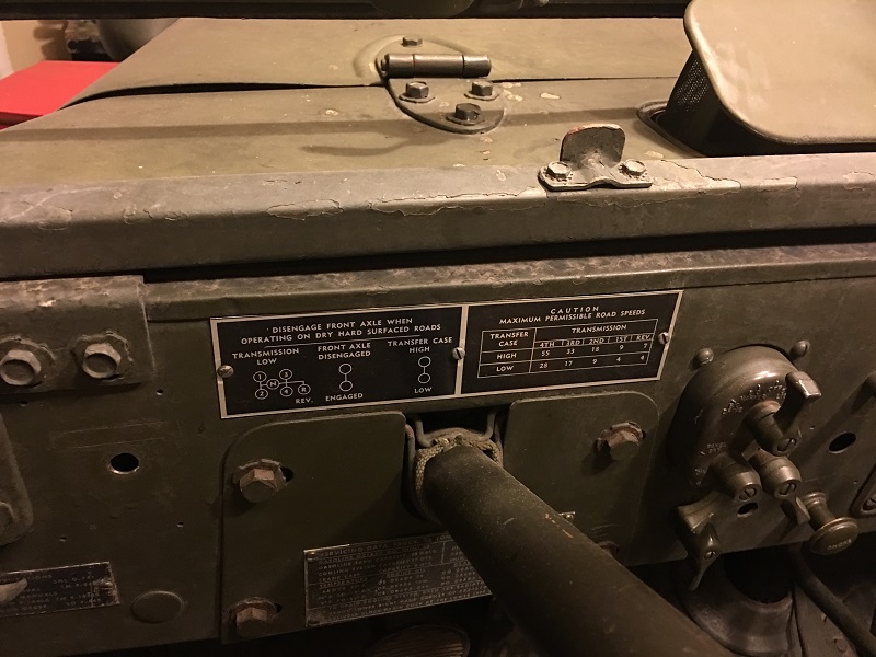

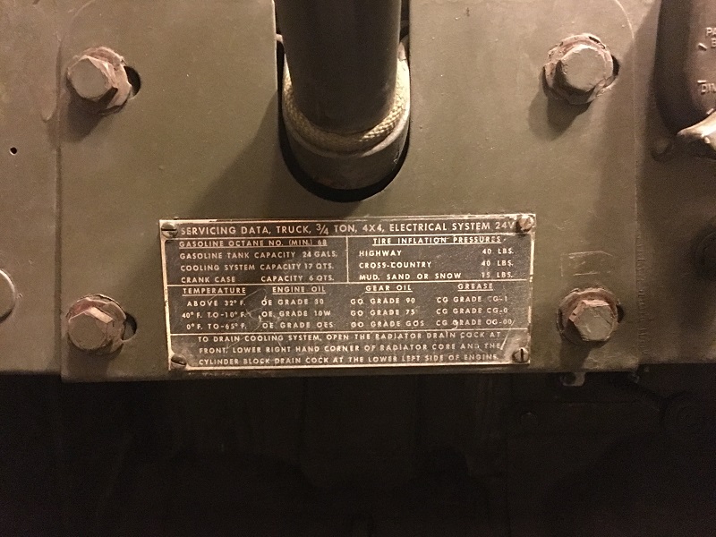

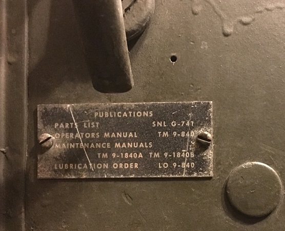

Hey guys I have a question and could not find the answer in the TMs. My 52 M37 is missing a few data plates do you know where I can find a resource that would list the data plates and where they are supposed to be located on the truck? The one in question right now is what plate should be directly under the steering column, it fits between 2 large bolt heads. Any clues would sure be appreciated!

Tm9-8030 has them all listed and pictured in the front few pages. I don't have mine near me or I'd give the page. Looked it up and it is page 14.
Servicing data instruction plate.

Here you go.
2016-07-24 20.47.24.jpg (107.75 KiB) Viewed 1041 times
2016-07-24 20.47.11.jpg (153.7 KiB) Viewed 1041 times
2016-07-24 20.47.30.jpg (169.57 KiB) Viewed 1041 times
