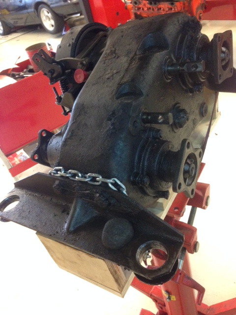

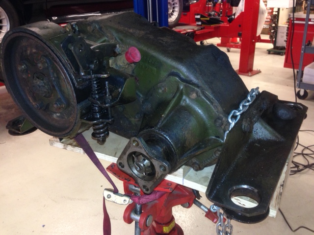

Hot gear lube actually works OK as a cleaning solvent. After 5K miles it's worked a large portion of the caked on mud loose and has kept a nice shine on the case :).
T-case 2.JPG (126.27 KiB) Viewed 3713 times
Check out the rock! It's been there so long it was polished smooth. Wonder where it's traveled?
T-case 1.JPG (113.86 KiB) Viewed 3713 times
Now the question is what to do with the darn thing. We'll clean it up Monday and see what lives under the crud. I'm not sure how much backlash these typically have, but if feels loosey goosey and was a bit loud. There was very little metal on the magnetic drain plug we put in 5K ago, so it's not eating itself alive, yet.

That's not just some random rock. That's the excessive tilt recorder. If it falls off, you've exceeded the maximum allowable angle of approach or exit. :wink:
I've always wondered who thought it was a good idea to put the parking brake on the backside of a housing full of lubricant, contained by leather seals almost guaranteed to leak? :?
I don't think that there should be much free play. Might be a good idea to pull the output shaft retainer assemblies and check the pre-loads of the brake, rear axle, and idler gear tapered roller bearings. If you've got slop in the gear train, it will be hammering back and forth as the drive train loads and unloads going down the road. Eventually, that's got to cause problems.
