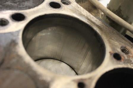

- Ouch! Should have fixed that darn miss!!! It's still standard bore and will clean up at .020" from what I can tell.

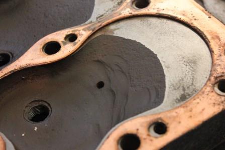

- '57-'59 Passenger car head, check out the nearest chamber. Weird!

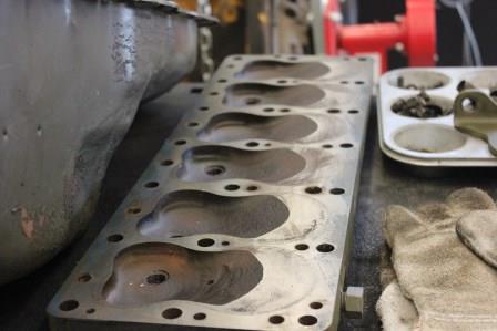

- Our oddball rod. Wonder what happened over the years????

- I'm wondering if the chamber was "cleaned up" at the factory. It sure looks strange, almost like a sloppy job with a mill...

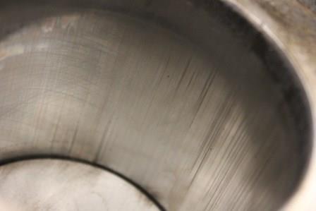

- Close up of Cyl. 2. It's too bad it has damage, the remaining cylinders would likely clean up with a hone.
