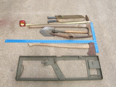

This is what I found out in the shed. Anything look right?
Pick & ax are both about 36".
Straight From The Chicken House Supply Room.
DSCF3417 - Copy (400 x 300).jpg (37.31 KiB) Viewed 3003 times
52 M-42
Posts: 741
Re: Pioneer Tools.
Post by 52 M-42 »
The axe looks right, the Pick / Mattock looks right (sharp point on one end and wide blade on the other end) and if the machete is 18" long that is what I used too.
Looks like all you are going to need is a shovel and straps.

A "T"-square??? What's that doing in the shed?
Seriously, looks like you have the correct axe handle, which they call a Fawn's foot. Almost all new axes have a variation of that where the end of the handle is not beveled the entire way, so it's not "correct" if you care about such details.

Well, the "T-square" was only for reference! I lied, it lives in the shop now and the "chicken house" was taken down several years ago now. BUT, that was their home back then! Forgot I had them! :oops:
