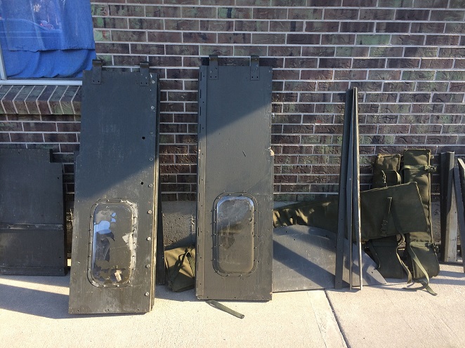

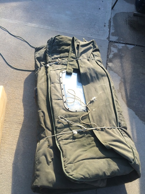

Here are a few, I think that it is complete but have no way of really knowing since I haven't set it up yet.
- IMG_0086.JPG (155.21 KiB) Viewed 2260 times
- IMG_0089.JPG (119.91 KiB) Viewed 2260 times
- IMG_0088.JPG (146.76 KiB) Viewed 2260 times

Thanks for the pics, Brandon. Looks interesting.

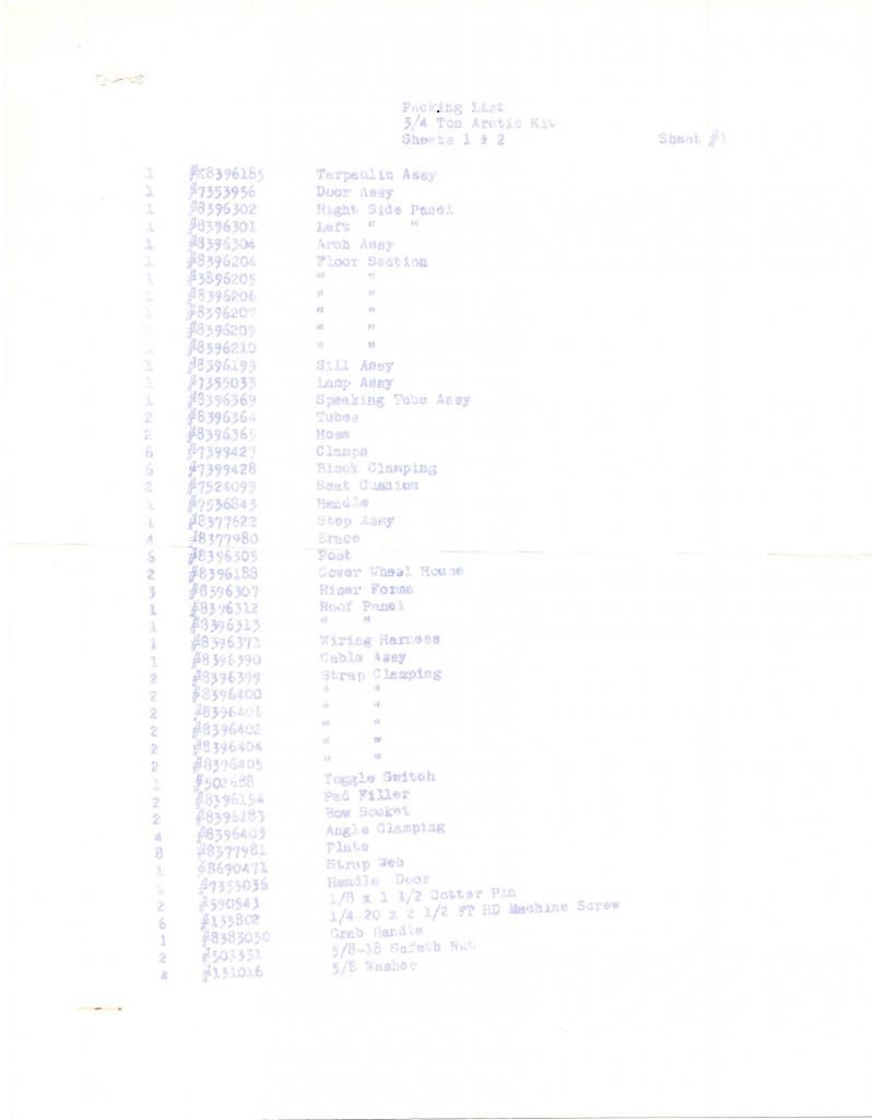

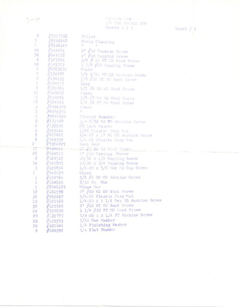

Here is a scanned copy of the 2 page packing list for the Cargo Bed Arctic Enclosure Kit. It is a mimeographed list so it may not be very clear. You may have to enlarge it to read it. the installation drawings are 3 pages of 24" X 18" (real old school blue prints) so I can't scan those. The list should at least give you an idea of what you are missing.
Good Luck!
