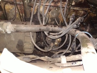

Looks like grandpa swapped the water proof plug wires for a more modern version. I didn't like they way this looked: the bottom of some of the distributor holes were rusty, and the only thing holding the plug wires to the distributor was the friction from the rubber boots. Some of the plug wires ends were also very rusty.
Given the price of the OEM waterproof wires, is there an alternative wire setup? Also, is the distributor cap an M37 inclusive or is there a replacement I can get at NAPA et al?

Rusty - what does the distributor end of your yellow wires look like? A solid strand of copper bent over? That's what I have...I'm wondering if there is a better solution.

Rusty - I'm still running the wires shown in my picture with regular plugs. I upgraded to a pertronix ignition and new coil and electrically she runs fine.
