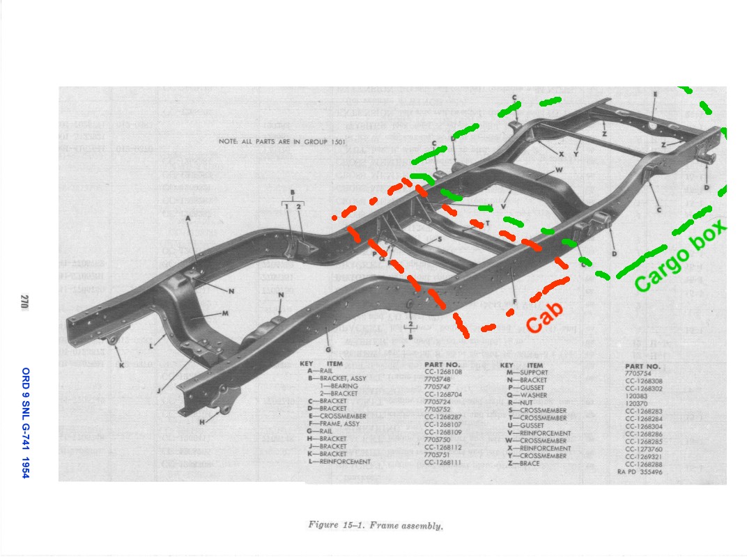

If I understand what you are asking the cab firewall sits roughly where the frame starts to narrow. It bolts to the running board hangers.
The rear pickup body aligns with the riveted on hold downs. The forward most riveted hold down aligns with the headboard of the pickup body.

The manuals only offer layout illustrations of the rear cargo and utility bodies not the cabs. The illustration above is the only cab fastening illustration in the manuals.
You can locate the cargo box mounting tabs easily and set the cargo box or just it's front section on the front cargo mounts and then position your cab.

Ok I need to put the running board hangers back on the frame before I place the cab on. The bed is in pieces so I'm not even going to worry about that. I just need the put the cab on the frame so that I can start to figure out where I want to put the motor and transmission.

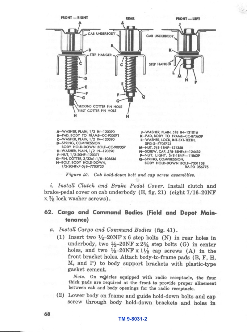

In the picture of the cab mounting bolts that Cuz posted can anyone tell me the thickness of part B and K the rubber pads? In my motor and transmission placement I need to take the hight of cab into consideration and right now the cab is sitting on the frame with no pad, so I want to get it sitting at the correct height.
Joe
Re: Cab placement
B-930571-Pad, silenite, 3 1/2 x 2 x 1/4" thick, hole for 1/2" bolt
K-875639-Cab to frame (anti-squeak) (No size info given.) Probably close to the 1/4" above.
Info is on page 328 of the 1954 ORD 9 SNL G-741.
Re: Cab placement
Thank you. Ok that gives me a quarter of an inch play before I have to make any modifications. Fun fun!.. :lol:
