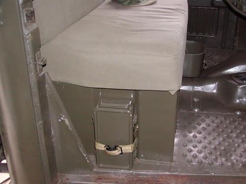

Dose anyone have a picture of how the First Aid kit is attached to the side of the passenger seat ? :mrgreen:

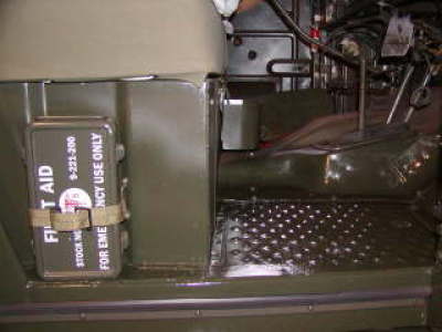

I have a few and am going to try to send them so bear with me.

Thanks Phil. But it looks like it will hit the door when you close it.. :mrgreen:

Looks are deceiving, the FA Kit showing is mine, & it don't hit/rub or anything.

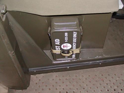

Those holes in the tri pattern are for the rubber bumpers, I see if I can snap a shot of them. (inside & out)

What I finally did was to use the two upper holes on the side of the seat to attach the strap too. I used 2 Truss head screws through the strap after making holes in it with an awl. I also found that the glove box door rubber bumpers were about the same size as the 3rd hole so I applied some silicone sealant to an extra one I had, and installed it. It does the job and looks good... :mrgreen:
