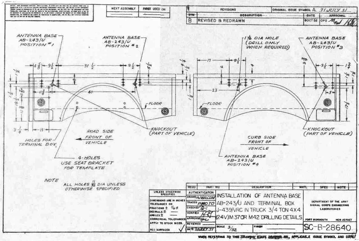

What mount would fit those holes because nothing I see so far I think does...
Re: What were these used for PIC's....
It doesn't match the 243 antenna base.
243 Ant base install.jpg (251.71 KiB) Viewed 2134 times
But it could be for an MP-50 mount which had 4 bolts centered on a 3" square.

I was looking at those... I thought I saw some with the hole not centered that's why I didn't think it would work... MP50 huh I'll have to re look at those... Yeah the other bases have way too many holes and your more than likely absolutely correct... What kind of radio setups were they running with those...
RT-66, 67, 68 which are part of many VRQ, VRC and GRC sets
