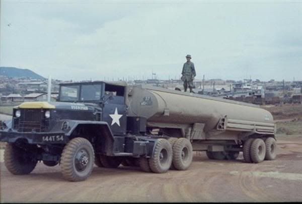

Ugly Ranger You got a great bunch of truck pictures!!!! I thought only the gun trucks had the yellow nose. Now you post a great pic of just a regular M37 with the yellow on the hood. Can you tell me more about this?
thanks
vtdeucedriver
Posts: 565
Post by vtdeucedriver »
May 69, orders came down for ALL 8th GP trucks to have their noses painted Yellow. This was so commanders in the air could watch their drivers while in convoy.

Now that is one nice tractor!!!! SO all 8GP trucks had the yellow nose stripe after may 69 ? Nice.
vtdeucedriver
Posts: 565
Yep!!

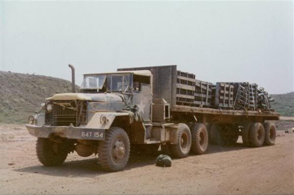

Not as nice as mine but a worker!!
vtdeucedriver
Posts: 565
Thought I would post one more!!!
For those in New England, come to our Vermont MV rally in July. I am giving a presentation on the LINEHAUL in RVN. Lots of pictures and info.
