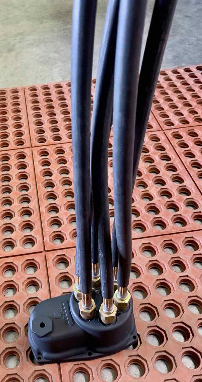

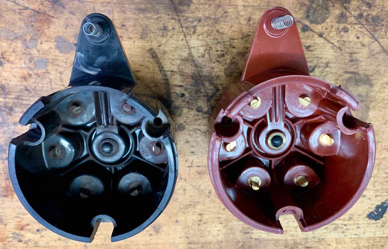

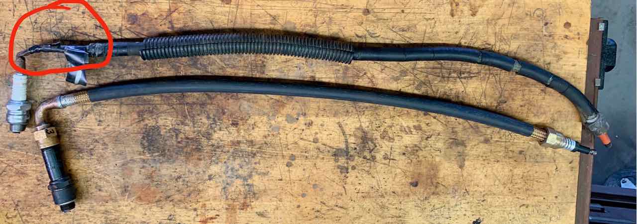

For everyone's comedic pleasure, I have posted a pic of one of the six wire (most likely an original) that was hacked up and spliced to utilize regular spark plugs vs. the new wires and correct plugs. It actually ran with the hack job wires. Pics of new vs. old distributor caps also.

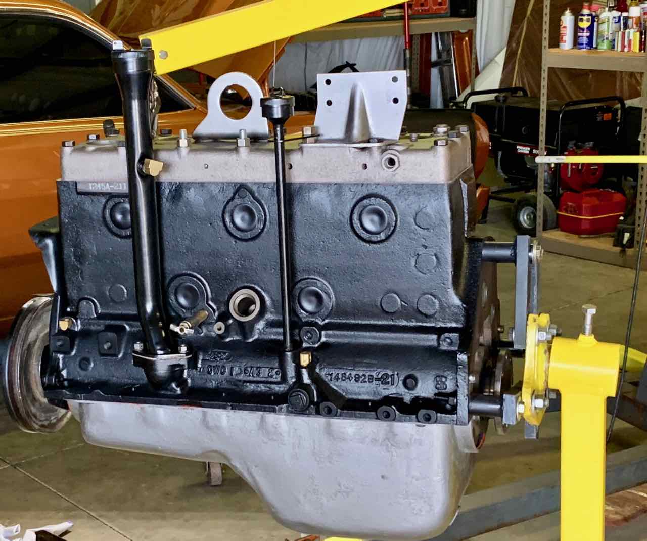

Some additional work completed on the engine today.
Paint head gasket/head installed
oil dip stick, oil filler, front pulley, installed.
I was given 3 spring metal pieces that snap into the drain-back holes in the block that are located adjacent the valves. Anyone have comment on these?

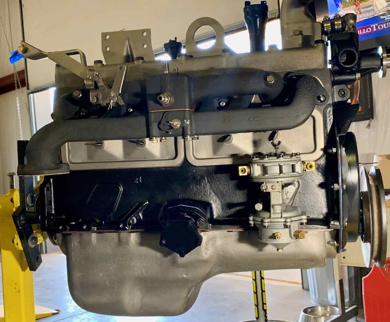

Even with the extreme heat, I get a little more completed each day. Today was only 104*F, last few days were 112-114*F.
Almost ready to drop into the M37.

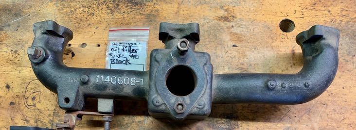

RMS, thanks for the comment. I did some work with the grinding stones and Dremel today. Not NHRA quality, lol. but should help the flow somewhat. If anyone is interested, I have one of these available. I think this is an older style intake due to the limited tapped ports. Part number is highlighted in silver Sharpie.

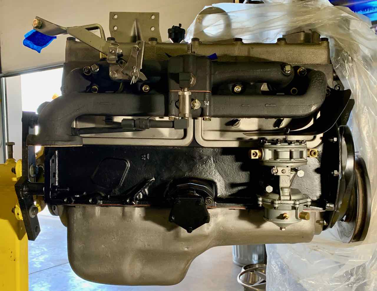

A little more done today. Intake ports massaged, manifolds bolted up, PVC installed. heat shield installed over fuel pump.

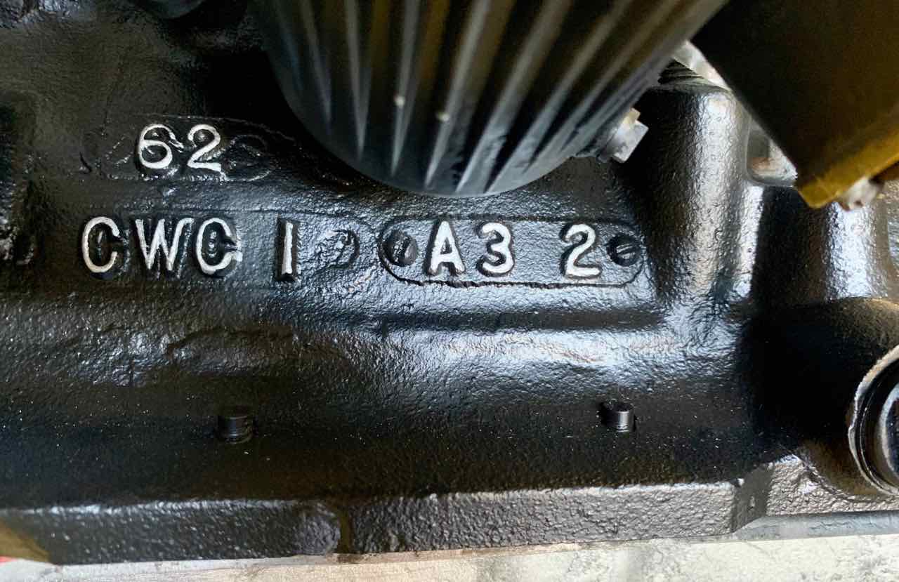

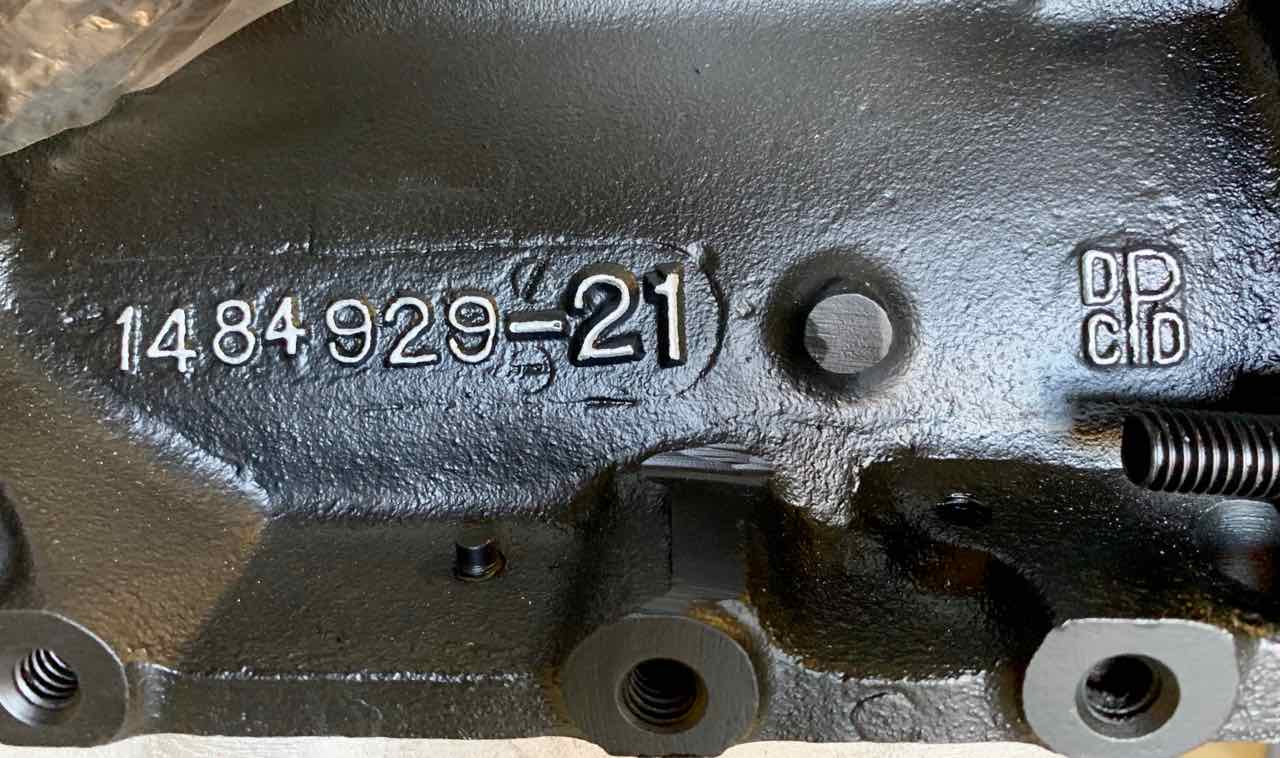

Researching the letters and numbers for the T245 block. Still looking for a good website that has all info, ( alpha as well as numeric) for these engines.
pic with "62" is below the distributor, other is the back of the block.

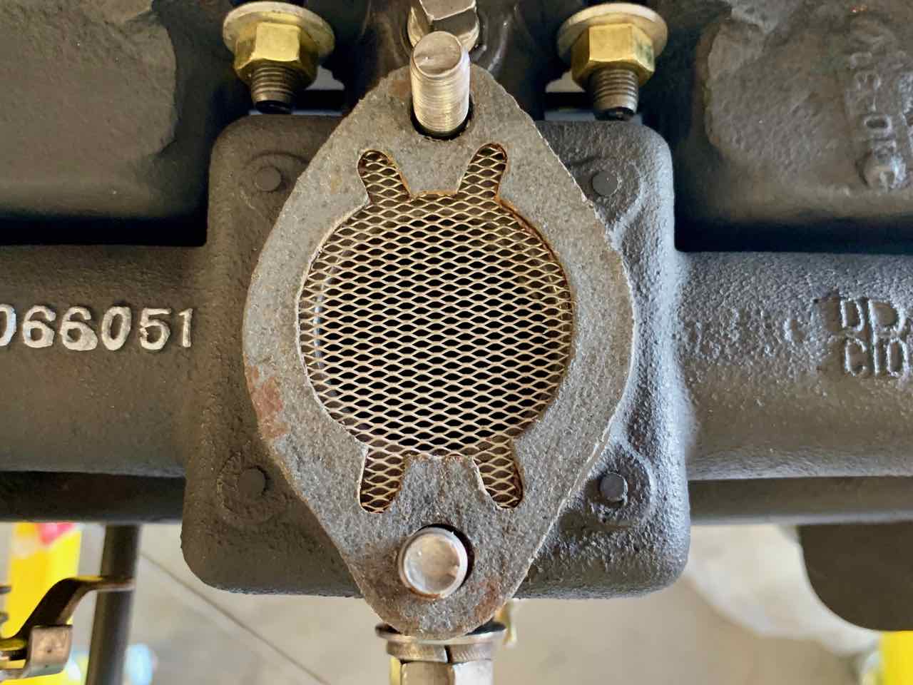

Many moons ago, An old salt mechanic showed me how to take two gaskets and a piece of window screen to make a sandwich, then put it under the carb to further atomize things. The mileage went up a bit, no notice of power loss. Smoother takeoff under WOT, too.
Funny what tricks work with these simple old engines.

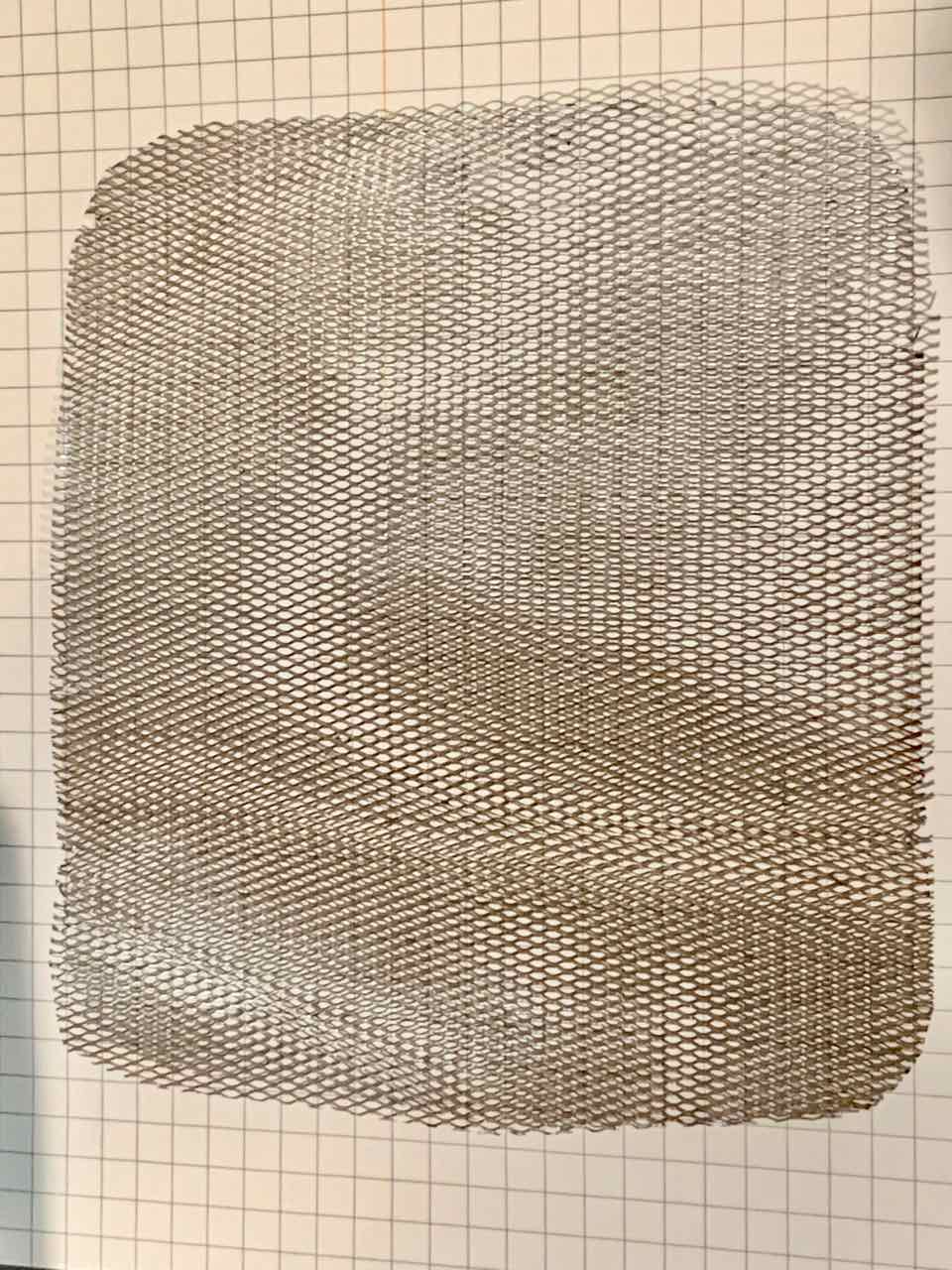

WOW, I forgot all about that trick. I do have a piece of titanium screen that I may try this with. I read about it in an old car magazine, maybe a Car Craft or Hot Rod. Dug around in the shed..................found it. I was going to use it on one of my Carter Thermoquad V8's. Never did, glad I never tossed it out.

Here is my home made titanium screen gasket below the carb.
We shall see how she does.
