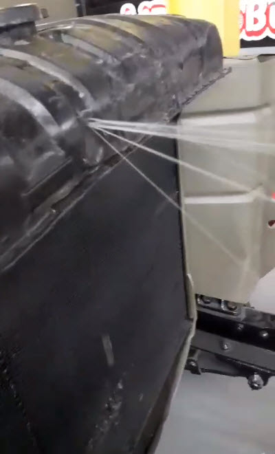

I just had a radiator re-cored. It was $$$! The price of cores has become nothing short of spectacular. Grant, the radiator guy, essentially cut off the folded seams and ordered a core to fit to the flanges that were remaining. It's not "original" but he felt it would be just as durable and more repairable if there were issues down the road. In addition the core had a different fin/tube matrix that should be much more efficient that the original design.
The radiator I had that failed peeled the entire front seam open when it went with a big bang. That was likely encouraged by a head gasket failure helping it along :shock: . If you decide fix the header tank, check that seam carefully!
Were you running a 4 psi cap?

I cannot tell for sure if the radiator is original, mainly because the Spanish army used to swap a lot of things at the depot. I don't have clear pictures where an original radiator is shown. And the cap, as far as I now, was a 7-8 PSI cap.
I am a bit scared of what happened. After talking with the shop we agreed the 3rd party that restored the rad didn't tested it at high pressure. But to be fair, the pressure was too high. The return hose was very swollen the few minutes the engine ran. I'm crossing my fingers not to have a head gasket failure. This shouldn't be, I mean the engine just got from the machine shop a few months ago and now we are back into running it.
I know it can happen but this would mean more time at full stop. Yes, better to prevent that cry after.
Now the radiator has been taken to another shop that will remove the head while maintaining the core. All this for 275€. It's the cheap option. Indeed, servicing this piece is really expensive!

The original M37 radiator has two, deep cores. This is the same thickness as a regular 4-core radiator.
The top tank overhangs the core in front, by some 3 inches. The tank takes a mil-standard cap, 4 to 7 lb rating.
Both outlets are cast iron, riveted then soldered in.
I hope this helps.
