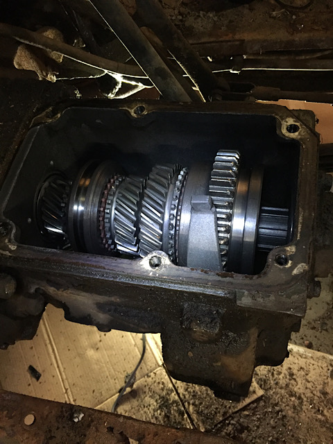

Since I was working in the cab and I had the sheet metal out of the way, I took a peek in the transmission. This is the T98 that came with the truck, and I’m surprised it looked as good as it did!

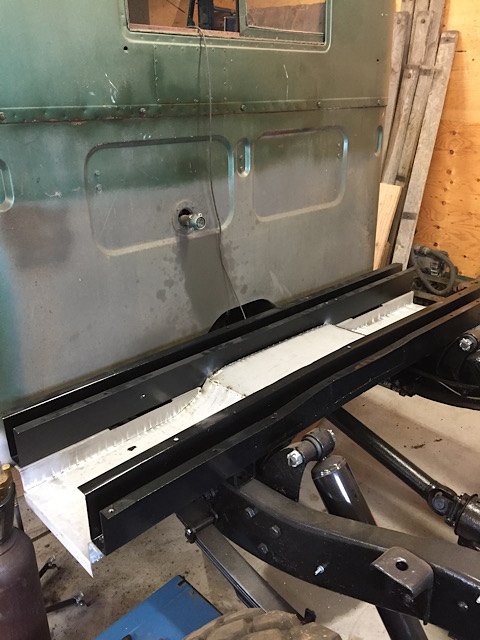

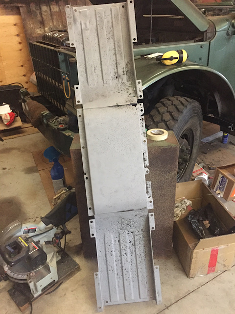

Then I went back to working on the bed area of the truck. The toolbox floor was pretty bad, so I used it as a pattern to make a new piece. I initially thought I could save it, but once it came back from the sand blaster it was revealed to be thin in most places and Swiss cheese everywhere else.
So, I ended up creating a new floor in 3 pieces which were then welded together to form the full floor of the tool box. In addition, I bought a new front crossmember from John at Midwest as the old one was beyond saving. The other cross member that makes up the rear wall of the toolbox was solid, but also quite bent from a log or something that had jammed up underneath the truck at some point in its life. It was straightened and saved, and is now back in the truck.

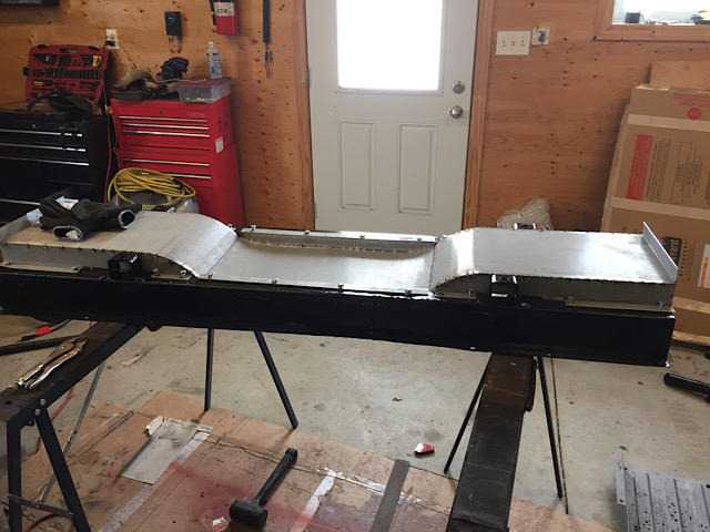

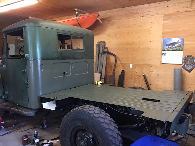

A couple pictures of building the new toolbox. I tried to keep it fairly simple, and did not add in the ribs that the old toolbox had on each end. I think being boxed in as it is it should be plenty rigid.
And here’s a picture of the bed floor back on over the toolbox. I painted the interior of the box white which will hopefully make it easier to find things inside it.

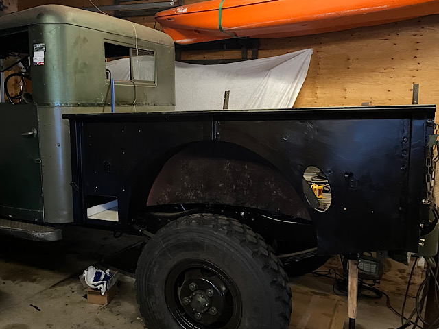

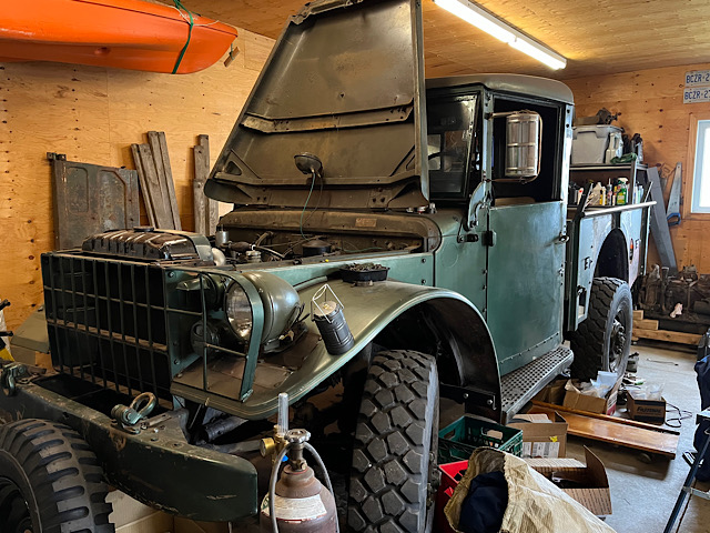

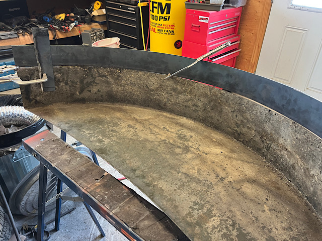

And that brings us to where the truck is at today. I’m working on the sides of the bed and the inside and outside wheel arches which had some significant rust. I’ll show you soon how I’m tackling that. It won’t be a professional fix, but it will look pretty good once I’m finished I think. Here’s a shot of the truck right now, and my very messy shop. It’s going to be nice to get back to work on the truck, and I’m hopeful to make a good deal of progress this winter.

Great pix, and the tranny internals look fantastic!

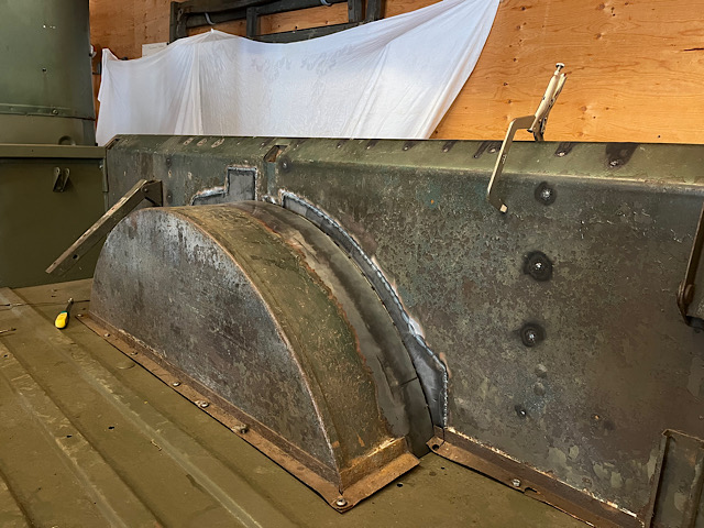

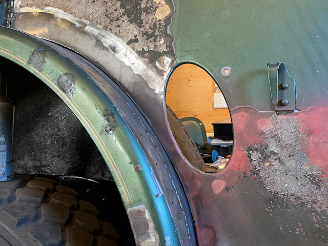

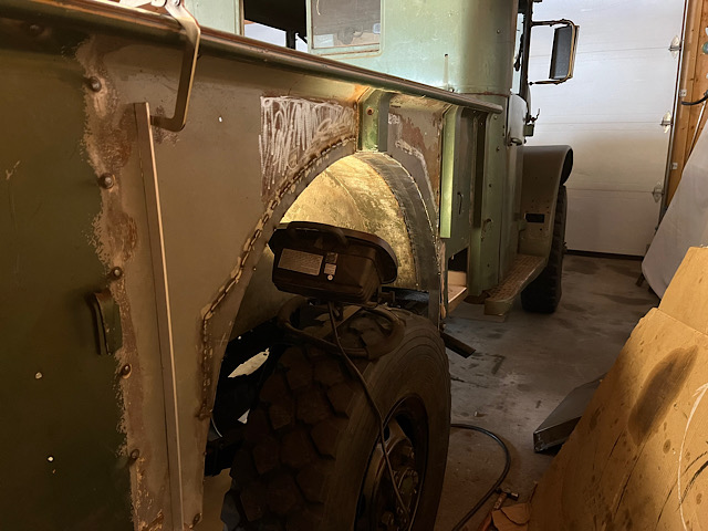

I have been trying to make a push to finish up the bodywork and I am finally at a point where I’m seeing the end of the rust. I’ve just about finished welding up both rear fenders, with only the outer passenger side to do still. As most of this was cutting and patching and fiddling to get everything lined up, I’m just going to let the pictures speak for themselves.
Pass side repairs
Pass side repairs
Inner fender repair
Inner fender repair
Patching around filler hole

The black paint is just to protect the fresh metal for the time being. We have been getting some pretty large temperature swings, and bare metal will flash rust if not covered. Once I’m done the welding I’ll be doing some sanding and smoothing so that the large imperfections won’t be visible.
Pass side outer
Pass side outer

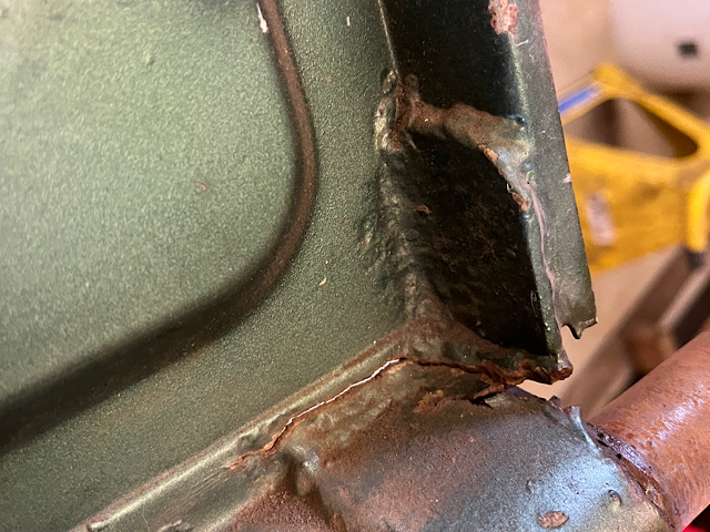

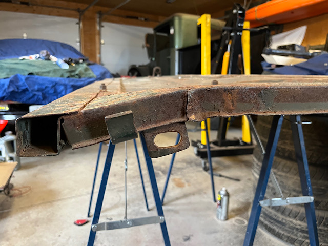

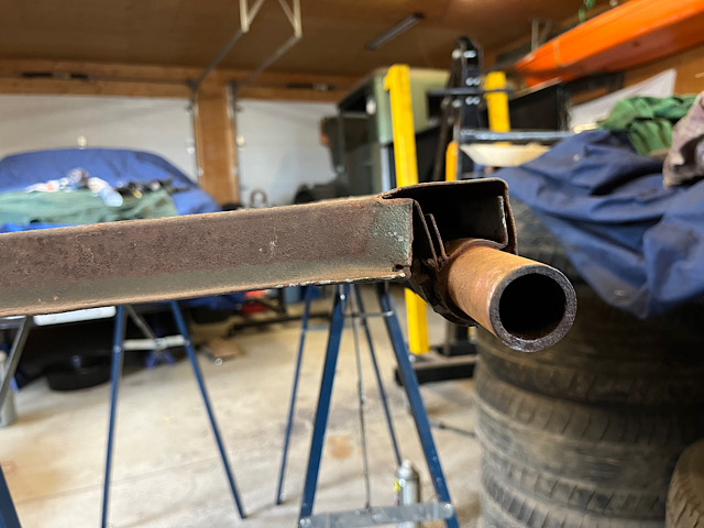

And finally, today’s job was some work on the tailgate.

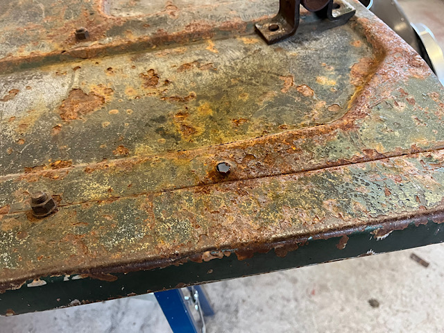

What I was starting with was fairly straight, although there were cracks in all four corners, the hinges had seized, and the top right corner had a fairly significant bend, and a crack where the metal had folded. So, with some pipe clamps, some heavy hammer and dolly work, and a bit of heat it was all brought around. It isn’t perfect, and that’s ok. I also left the bullet hole, because… it’s a conversation piece.
Cracked through the lower reinforcement- same on both sides
Twist at the hinge
Twist at the hinge
Top pass side bend
Top pass side bend
RCrombie

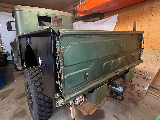

Last of the tailgate pics

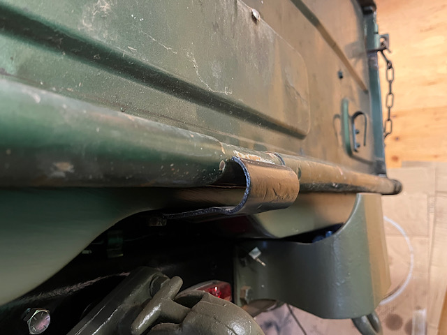

About the center support for the tailgate: Mine sits a bit low and doesn’t seem to do much. Has it been flattened? Off the truck the part doesn’t look warped, but on the truck it just doesn’t seem to sit quite right. Does anyone have a picture of theirs they could share so I can see if I need to tinker with this?
Straighter, and back on the truck!
Aforementioned bullet hole

Glad all this hard work is giving results, Rob.
Note that before acquiring my tailgate (the truck lost its original who knows when...) the ones I was offered had the lower corners above the hinge rusted. I don't know why but the frames on the sides were rusted too (I've seen tailgates having a thick piece welded from top to bottom on the sides for this). Regarding the center support, I have never seen a truck having the tailgate up and the support completely fitting, it sit a bit lower. Sorry I don't have pics now.

Those center tailgate brackets always seem to sit low-a vise and a BFH will get 'em where they should be. I wouldn't hammer it within the mount or you could break off a well nut.

Is the tailgate supposed to be able to drop all the way down until it hits the bumpers? Mine hangs up on that center support, leaving the tailgate in the way when I'm trying to load heavy objects.

John Mc wrote: Sun Feb 25, 2024 7:25 am Is the tailgate supposed to be able to drop all the way down until it hits the bumpers? Mine hangs up on that center support, leaving the tailgate in the way when I'm trying to load heavy objects.
No. Mine did the same as it was very bent. I took it off.
No more issues.

I have not removed mine. I'm thinking I might want that support in there for when there are heavy loads on the tailgate.
