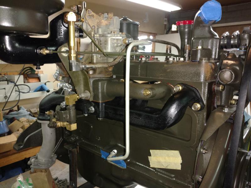

				Not posting much, but things have progressed. Got a new pan from John and some odds and ends from he and Jens. Fabricated all the lines and just done a bunch of fiddly bits. The carb is off and I'm taking it to the local plater to have it passivated and chromated. Then rebuild it. I'm hoping that helps with the prevention of white rust inside.
I've also pulled the starter and generator for freshening up.
I've got everything for the trans rebuild but the special snap ring. The case is in the soup right now. Every day a little bit.

Interesting routing on the vent line between the air horn and the oil filler tube.  Mine was more horizontal, routed above the fuel line into the carb bowl.  Is there a reason for the extra fittings coming down from the air horn before going across the head to the filler tube?
Did you repair your oil pan, or find an NOS one?

				That was how the existing piping was run. I don't have a tube bender that size, so I just see the original tube. I would have liked to route it differently, but it works.
New oil pan from MWM.
I used a later air horn than the original for convenience in plumbing. Now I have one each new and original air horns spare in the swap meet pile.

				Umm.. You may want to rethink your copper plumbing.  Copper tends to crack from the vibration when used in cars/trucks. Other than that, looks great.
-jim lee
				Re: Just another engine build thread. Sort of.
				Posted: Sun Sep 17, 2017 2:23 pm
				by just me
				That isn't copper. It only looks like it.
