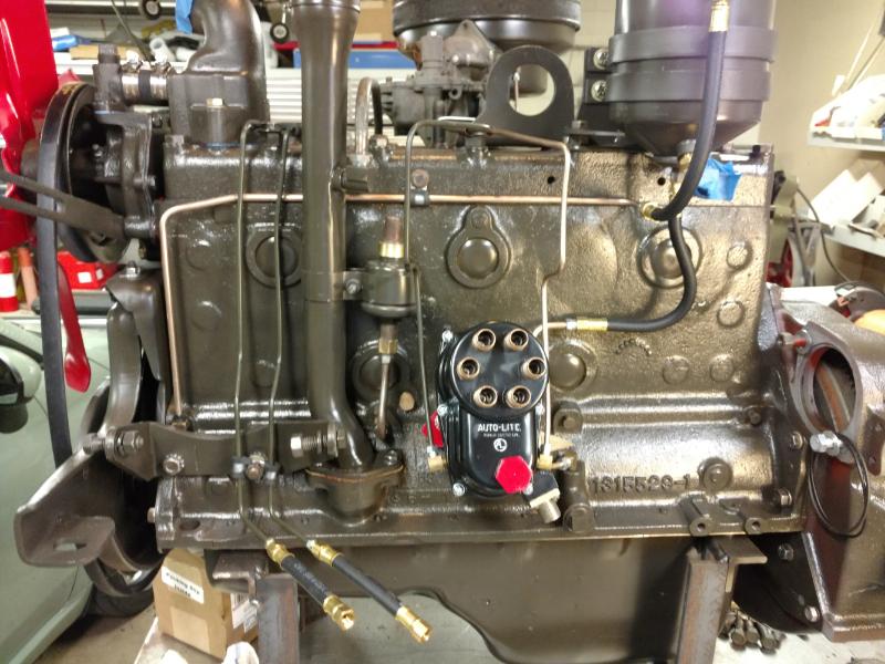

Not posting much, but things have progressed. Got a new pan from John and some odds and ends from he and Jens. Fabricated all the lines and just done a bunch of fiddly bits. The carb is off and I'm taking it to the local plater to have it passivated and chromated. Then rebuild it. I'm hoping that helps with the prevention of white rust inside.
I've also pulled the starter and generator for freshening up.
I've got everything for the trans rebuild but the special snap ring. The case is in the soup right now. Every day a little bit.

Interesting routing on the vent line between the air horn and the oil filler tube. Mine was more horizontal, routed above the fuel line into the carb bowl. Is there a reason for the extra fittings coming down from the air horn before going across the head to the filler tube?
Did you repair your oil pan, or find an NOS one?
Posts: 1282
Re: Just another engine build thread. Sort of.
That was how the existing piping was run. I don't have a tube bender that size, so I just see the original tube. I would have liked to route it differently, but it works.
New oil pan from MWM.
I used a later air horn than the original for convenience in plumbing. Now I have one each new and original air horns spare in the swap meet pile.

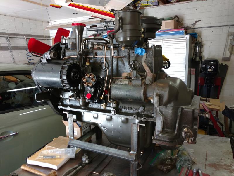

Been a month and just getting back to the project.
Carbs are plated. Need to assemble one.
Need to finish touch up paint on the engine block and mount the carb.
The transmission is together.
The shifter top is almost done. Just need to assemble it now.
Waiting on 1 part to finish the PTO rebuild.
Then it will all be mated into a power unit for the swap into the truck. At that time, I will do the rest of the swap back to 24Volt.
Did repair the slip yoke on the rear driveshaft that was dead. Makes a big difference in quieting the ride down.
Also, had to do repairs on the M38 after its maiden voyage 300 mile backroads trip. But that is all sorted out and it is back to its smooth running, shiny and clean glory.
I'll shoot some pics as things progress.

Trans and top are done. I can't find where I put the shifter lever. Tonight, the PTO gets done. It is ready for assembly.
The RT70 radio is nearly operational. Finishing up the alignment.
Started painting the replacement inner fenders and radiator supports.
Soon. Soon.

Umm.. You may want to rethink your copper plumbing. Copper tends to crack from the vibration when used in cars/trucks. Other than that, looks great.
-jim lee
Posts: 1282
That isn't copper. It only looks like it.
