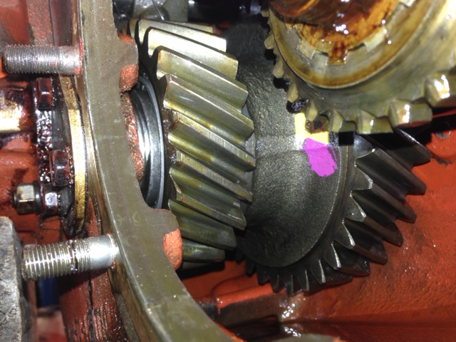

- So far this is how the gears look. The brown you see is congealed assembly grease. The actual gear lube looks normal.

Spent some time cleaning and inspecting the "new" transfer case today. It's best to do this without the "help" of my students. It is actually NOS and in excellent shape

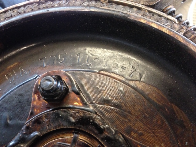

The date on the case is seen in the attached photos, 11-16-1971. I spoke with the vendor today and found out the story behind the case. It was in Dubai of all places. It was intended for use as spare parts for an oil drilling operation. I guess he picked up a few of them. Looks like the desert climate treated the case well. The case had Power Wagon/M715 style flanges and rubber lip seals which is interesting. I pulled the guts out and the only issues seem to be from the grease used for the needle bearings. It had turned to a tar like substance and stained the shafts and bores of the gears. Fortunately it polished out with some 000 steel wool. I'm going to replace the rollers. All of the ball and tapered roller bearings looked new. As far as set up the end play in the idler is .002". When I set up the rear drive gear with the original shims and no seal the torque to turn the gear was 25 in-lbs, nicely between the 15-35 in-lbs listed in the manual.
Needless to say I'm happy so far. Hopefully we'll get it buttoned up this week and in the truck for a test run. I will say I believe this was by far the most cost effective way to deal with this and the advice I've received here is invaluable.

M715 trucks were only built 2 years, '67 and '68. If your case was built in '71, it was likely one of the last ones furnished as M715 replacements parts. Sounds like you did indeed end up with a new one, it is all in how these components were stored. Bad storage has been the demise of many components.

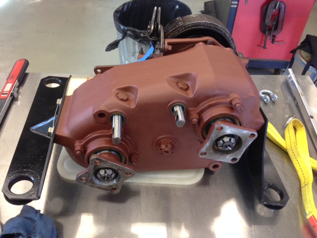

We completed the install today and I drove the truck home via city streets to give things a chance to break in. The T-case is quieter, but it's still a NP200! I think it's going to take some time to loosen up, it was nowhere near as "free" as the old T-case. Of course it now has some bearing preload and actual seals! I figure I'll stick with some city driving on my 10mi. commute to work for a few days. It will get things warm and have a bunch of on/off throttle. I'm going to break it in like a diff.
Improvements at this point are: no leaks, no more buzz in low range, no more mystery clunk, much less backlash in the driveline, quieter operation.
I'm waiting to see how it reacts to extended 55mph cruise. I hope that it frees up a bit and does not run hot on the highway.
