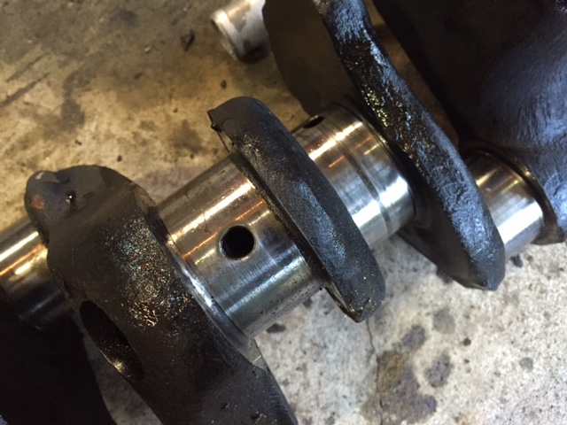

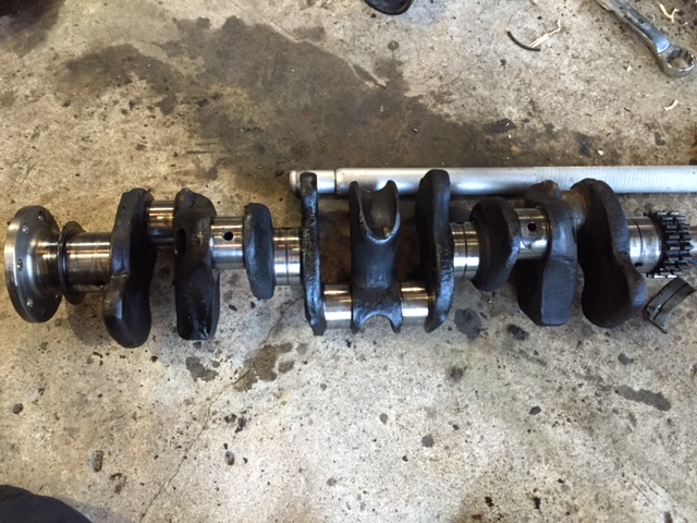

Crankshaft seemed to be in good shape
All the journals seemed free and clear. All the bearings were in decent condition

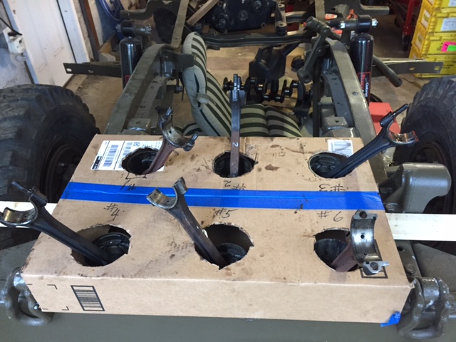

I tried to keep the pistons in some kind of order as I was taking them out, but realized it wasn't going to matter so much.

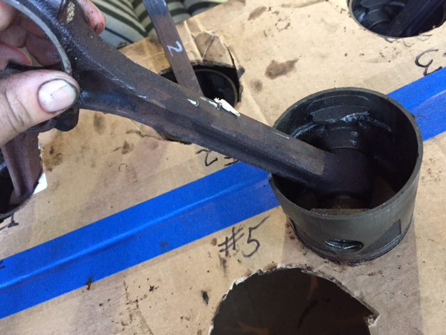

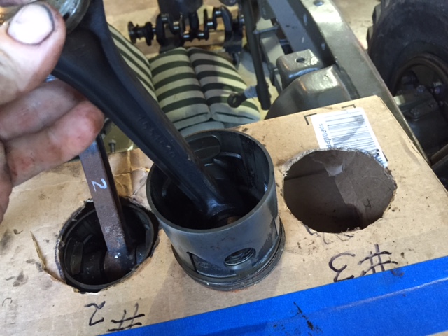

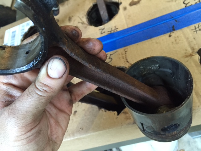

I started to notice some details as I got deeper, like how some of the pistons (1,2,5,6) had rusty rods. 3,4 were not. Here's a rusty one
Yet this one is ok
Does this mean I had some kind of a clogged oil journal somewhere? How would they even be rusty in the first place? Wouldn't that mean there had to be some water/condensation in there are some point?

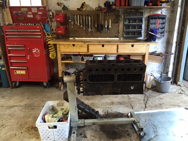

OK there she is. Last thing I still need to do is pull the valves and springs, but I need a special tool to do that apparently so I will have to figure that one out.
This things looks pretty rough. Has anyone had any experience with a rebuild like this where the thing looked like it might have been in the bottom of the ocean or something and they were able to get it running again? I have my doubts, but I am going to keep at it.

It looks to me like you are now ready to go talk to a machine shop. If that block is good, now is the time to rebuild it. The machine shop will tell you what can be used and what needs to be replaced.
Be sure to get a reliable, honest, and experienced machine shop who knows how to rebuild old engines.
Meanwhile, back at the garage, you get to replace brake lines and systems, replace the fuel lines, boil out and coat the inside of the fuel tank, tear apart and rebuild steering, transmission, transfer case, front and rear end, and don't forget the body work and rewiring. Don't forget the radiator, shocks and springs either. :shock: :mrgreen:

There's nothing wrong with that No. 4 piston that a little JB Weld can't fix. :lol:
Seriously, though, don't stop labeling and organizing, even the parts that you know can't be re-used. More than once, I've gone back and examined defective parts to determine why a failure occurred, and having the relevant parts identified and available has been useful. My SOP is to keep everything until the project is back together and operable, and only then scrap the unusable leftovers.
I fully agree with Storm's advice about finding a "reliable, honest, and experienced machine shop". I'd add two things: first, find a shop that wants to work on something unusual like these old Chrysler flatheads. Some shops are production places, and if it isn't a Chevy small block, it's the odd duck out and gets treated as such. I use a guy who does race engines and antiques, and I could tell by the look on his face when he first saw the T245 block I dragged in that I was in the right place. He wanted to work on it.
Second, learn as much as you can about engine rebuilding before and during the process. Don't just rely on the machine shop to know what to do and how to do it. It's like a medical procedure; you want the best expert(s) to do the work, but you'll end up with a better result if you're involved and knowledgeable about what's being done. For example, I wouldn't spend a dollar on rebuilding an engine if it wasn't going to be balanced, but not all shops think it's worth it, especially on an old flathead like these.
Unless the parts are pitted, don't worry too much about the surface rust. At least not until the parts are cleaned up. The shop will likely thermal clean them, and then you'll know what you've got to work with.
Did you look at the backside of the connecting rod and main bearing inserts that you removed? If the crank bearings have previously been ground undersized, the bearing shells should be marked with the undersize amount.
