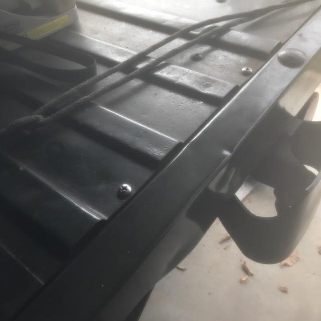

Not on mine either, checked this afternoon.
No extra holes
No extra holes

No extra holes in mine, either.
