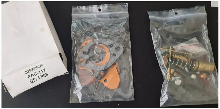

Opening the brake cylinder (because no braking at all), releveled a lot of corrosion inside. Just thinking about purchasing a new one instead of going for the repair kit.
The fuel pump is not working, no pressure. But we saw this coming.
I will not judge the carburetor's performance due to this lack of pressure so I'm crossing my fingers this one still has a chance. Just to be on the safe side I checked a few distributors/collectors here and the ETW1 is a pain in the arse to find. And if lucky enough I need to get somebody willing to sell without the core in exchange (remember the filled cracks...?). Guys at the shop recommend to switch to a modern carb, but I'm reluctant.

Argine1978,
The ETW1 is a nice carb and works pretty darn well. When we ran the our M37 on the chassis dyno the mixture was near perfect and the governor is useful once you have it dialed in. I've resurrected a couple of ETW1's and they are not too hard to deal with. One was really funky and we cleaned it up by blasting with baking soda. It's on the truck now and works great. Another was from a truck involved in a fire. As an experiment we filled the float bowl with WD-40 and let it sit for a few days then flushed it out. Then we set up a gravity feed to try it. It worked well!!!!
Issues I've seen are corrosion which can destroy the body, poor float setting which I've seen lead to fuel starvation under heavy load, wonky accelerator pump seals that are too tight or just destroyed and warped top covers which don't seal vacuum and lead to issues with the accel pump and other bits. In California we have 10% ethanol in our fuel and use a winter and summer blend. This stuff is crap. I use the truck frequently so the fuel does not sit in the bowl (or gas tank!) long and I suspect this helps keep things alive. If you let the ethanol stuff sit it can cause some corrosion issues (but it sure does clean out the system!) and if you have winter blend gas in an M37 when the temps go up you can have some vapor lock issues on hot start. Usually you'll need go to WOT during cranking and then lift the moment it starts.
I'd bet your ETW1 can be saved.
Re: My 1952 Dodge M37 re-building process
Be aware not all ETW1 rebuild kits are alike.
I have seen where a kit sold as compatible is missing several important parts, especially the accelerator pump vacuum piston parts.
Other than that, the ETW1 is as good a carb as one might want on the older flatheads. 8)

I bought mine from eBay. But it was fairly complete.
Note that my carb was just the core. Not even gaskets. Had to procure everything...., even the choke level was missing.
I do have faith it will work.
Sebastian
Looks correct from what I see.
The complete accelerator pump is the key to a good rebuild.
