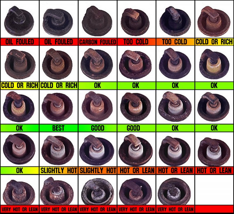

Yes, I noted that too the first time. I didn´t correct that neither.
But seems that a configuration like that works better?
Imagefuel near my location
Posts: 435
Re: Need help finding TDC
What I can't tell is: is that plug a little better configuration for this engine, or is it just better at masking a too rich mixture?
I have had my military plugs out from time to time, and have found that even a few minutes of idling will make them have some "carbon" on them, from running a bit rich at idle. But they should all look the same, or very nearly so. Plus, be carful to tool long a center ceramic electrode, as the clearance from the center of the plug is very near the exhaust valve on some cylinders. I found when doing a compression check with my MAC tools compression tester, which comes with both a short and a long screw-in adaptor for the plug hole, that it can touch the exhaust valve. Also, military and civilian plugs need to be the correct "heat range' for their use, both for the keep the plug "clean" and to avoid detonation.
When I had my rebuilt by me engine further worked on by Charles Talbert's team, he told me that it is necessary to bolt the intake and exhaust manifold together, and then have their mating surface to the cylinder head machined to be sure the mating surfaces to the head are perfect. I had just bolted my two parts tougher. So perhaps your mating surface of the intake and exhaust manifolds do not perfectly fit the cylinder head, leading to some leakage. I found that even though these are ancient designs, and very simple, they have to be assembled with great care and precision.
Also, I use new copper washers every time I reinstall my plugs, I get them in packs from Jegs racing. I think the torque is 30 pounds or so.

John Mc wrote:What I can't tell is: is that plug a little better configuration for this engine, or is it just better at masking a too rich mixture?
true: it is just better at masking a too rich mixture!!
