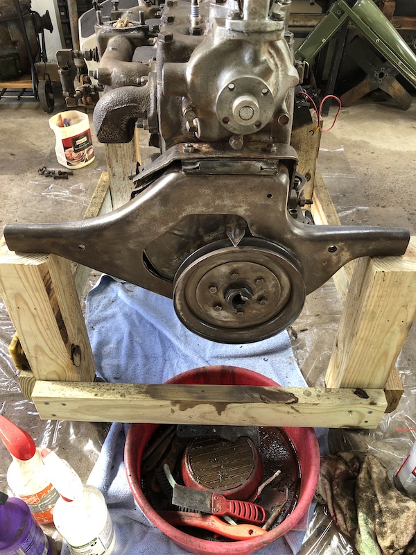

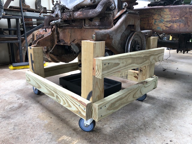

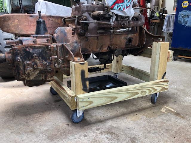

With the engine out, I needed a crate or something solid to hold it for a while. I am removing accessories a several components so I can paint it. Went to the hardware store bought some wood and built this. Once this engine is installed, more than likely I will use this crate for the spare engine from the parts truck.

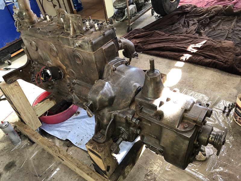

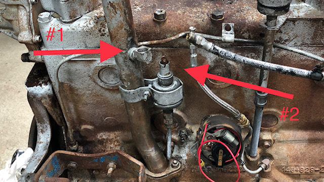

Take a look at both arrows. What you see here is how I got the truck when I bought it. Nothing was connected here.
1) Arrow #1. Crankase ventilation outlet. Since there is no original carburetor, what options do I have? Do I just plug the ventilation outlet?
2) Arrow #2. With a 12V system, what oil pressure sending unit I can buy and install? For sure I want to have a working oil pressure gauge.
(This truck was converted to 12V by the previous owner and he replaced the original carburetor)
Thanks!

Explorer0863 wrote:Take a look at both arrows. What you see here is how I got the truck when I bought it. Nothing was connected here.
You won't want to plug the crankcase ventilation. What you're looking at is actually the inlet air to the crankcase ventilation system. The Plymouth/Dodge small block flathead sixes have the crankcase outlet on the opposite side of the block, towards the rear, which is normally plumbed into the intake manifold on an M37 (on civilian applications, it just had a "road tube" open to the atmosphere, pointing down towards the pavement - no emission controls!), through a shutoff valve for fording.
You could just leave that port open on the oil fill tube, but if you can't re-connect it to the air cleaner side, you should at least put some sort of baffle or filter to prevent dirt and water from getting into the crankcase.
I'm not versed with the 12v conversions, but someone here will know of a 12v sender that works.

Nice engine stand! I run 12V, and my OPS came with my Auto Meter gauge set, so I can't help you there.

Hey! pressure gauge will work with pressure, its a little hose that goes from the block to the gauge, it doesn't work with voltage. Just the light...

I have a functional dash original oil pressure gage, but installed an Autometer mechanical oil pressure gage on my steering wheel column, and also a temp gage for my transfer case, via a sensor in the NPT fill plug.

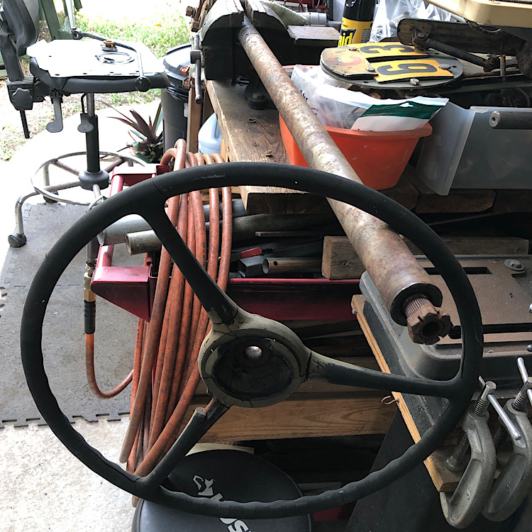

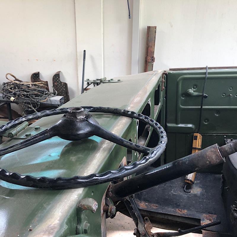

Today was my first day working on the M37 in 3 months. Decided to tackle one more time the steering wheel. Had to use brute force with an air hammer and a heavy sledgehammer but the good news are that both wheels are out and didn’t break any of them. Tomorrow I’ll be painting the chassis and if I have time, later this week I’ll be painting the engine.

Nice to hear from you Tony! Those steering wheels hang on like the devil! Bert (T. Highway) brought a steering box to me at one of the MVPA Nationals so we could use my puller to get it off-with the right puller it's an easy job! :)

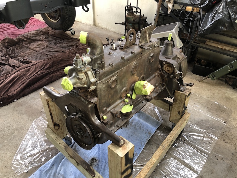

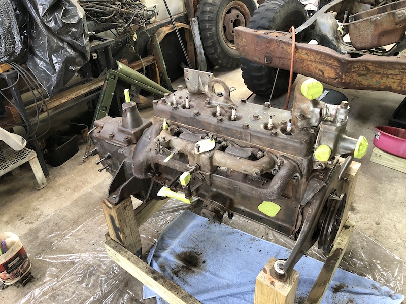

Hello everyone. Sharing a little bit of the progress. Here I am getting the engine ready for paint.
Tony

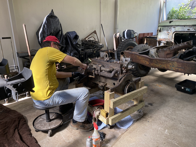

Post by Explorer0863 »

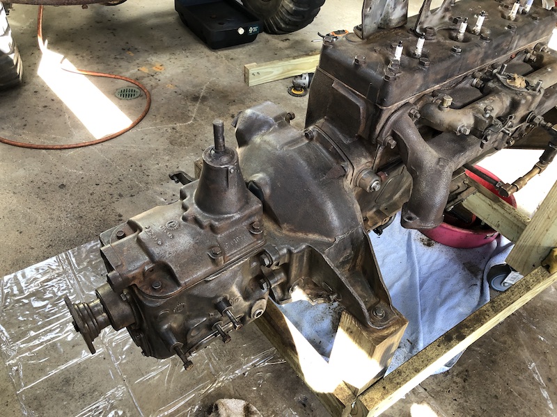

More engine prep.
