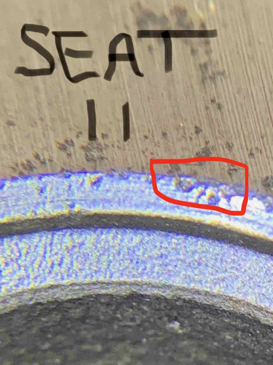

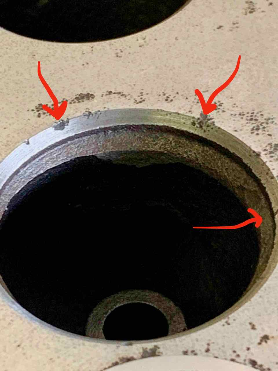

I see a crack between a headbolt and passage.
outpostm37
- CPL
- Posts: 128
Re: Rebuild time on the 230 flat head engine
There are two head bolt/water passages that have a discoloration from previous head gasket leak. This shows as a crack. There is no crack at those two points. The picture is deceiving. I am however having intake seats installed. Shown are two seats in the block that were ground, but I was not happy with the condition afterwards. These did pull and hold vacuum, but I felt that they may burn through at some time in the future.
- Intake seat 11 (1).jpg (106.4 KiB) Viewed 3358 times
- Intake seat 10 (1).jpg (92.04 KiB) Viewed 3358 times
That crack he is talking about appears in the before AND after pics of the block surfacing. Not easy to see in the before shot since that set of holes is a cylinder further down but sure looks like it is there in that shot also. I know we are armchair quarterbacking here but I am seeing a pattern of stuff that should not be coming out of a quality machine shop, especially that valve seat. It appears that the area below the head bolt is all part of the same water passage so the crack may not be too much of an issue, there will be water below the bolt anyway. There does not really appear to be enough meat there to hold a Helicoil that effectively. I would be sure to use Permatex liquid teflon on the bolt threads to at least try to seal it up a bit and be sure to run antifreeze to prevent rust.

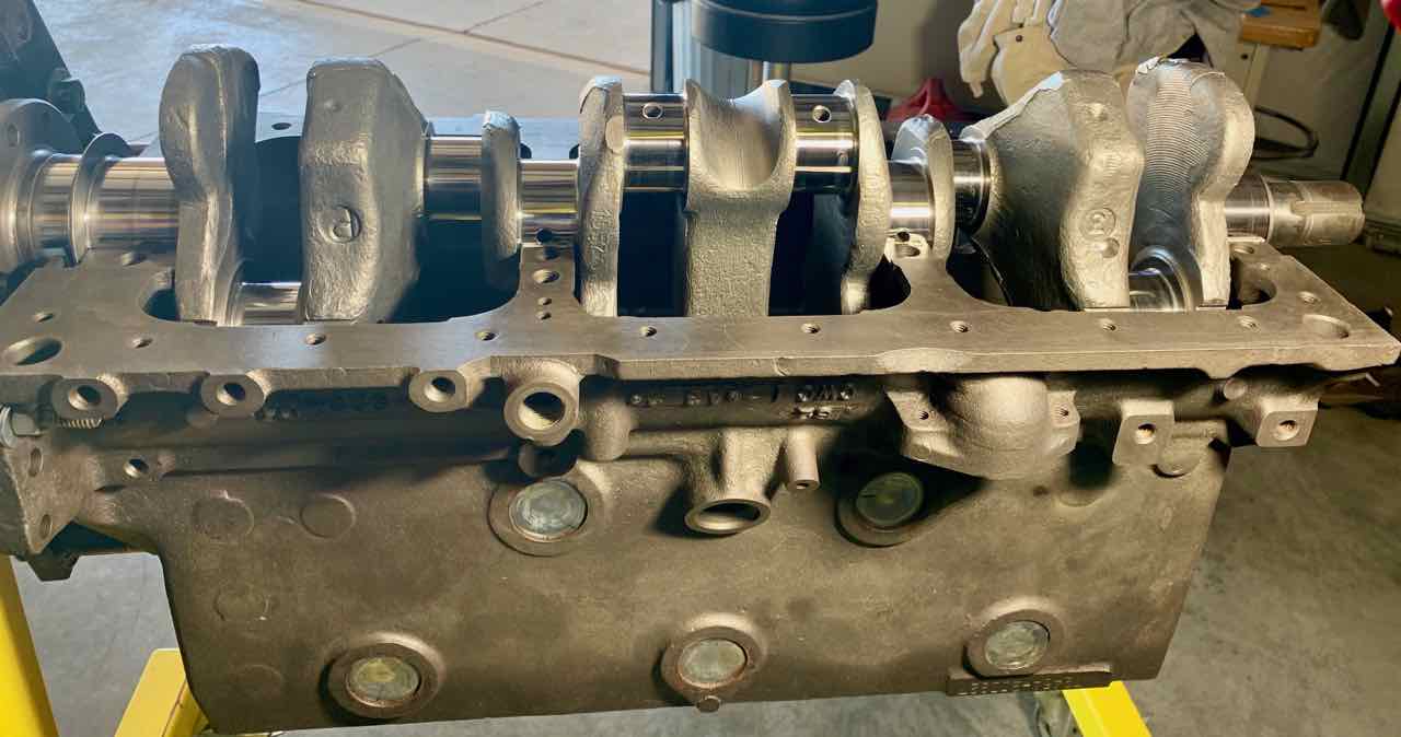

Using the green Plastigage, which is rated from .000-.003" I measured .002" on all except the rear main bearing. The last bearing clearance was just under .002" clearance. There are more accurate ways to measure bearing clearance, but this was the system that was available at the time.
- 230 crank in block (1).jpg (93.45 KiB) Viewed 3296 times

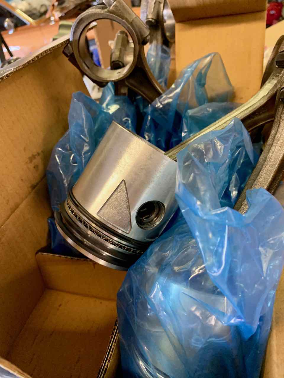

The Sealed Power .060" over size pistons are pressed on the rods, and Hastings rings mounted on the pistons. The pistons with wrist pins all weighed in at 571 grams. This along with the crankshaft-flywheel-clutch pressure plate balancing, should help with a smooth running engine. The conrods had a weight variation of 7 grams low to high. The previous set of conrods varied 20 grams.

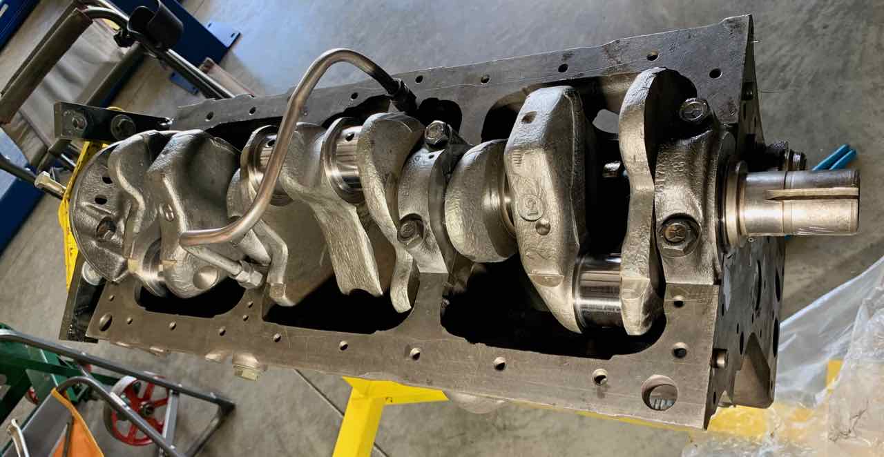

Back from the vacation. Crank, oil pickup, oil line, Cam, installed into the block. Had to do some light work on the front camshaft bearing. When the cam was installed fully, it was very hard to rotate. The front bearing had a tight spot that needed clearance work. There was s section that was "shiny" on the bearing.
- 230 flat head crank in block (1).jpg (99.45 KiB) Viewed 3251 times

Looks like things are coming along nicely. FYI the Sealed Power pistons have .020" less compression height then stock. If you're milling the head and care to do some measuring raising the compression is free power and MPG. The chambers on my current motor are 80cc and yield 8:1.
.020!? That is a substantial reduction in compression from stock which was already very low. Why would they do that? Are you sure it is .020?

Just measured the factory piston top to top of wrist pin- 1.565"
The new Sealed Power pistons are 1.545"
Delta .020"
The new pistons will sit twenty thousandths deeper in the hole.
Glad I milled the head .020" and the deck .010"
Pistons made in India, all six measured 571 grams with wrist pin.
Delta .020"

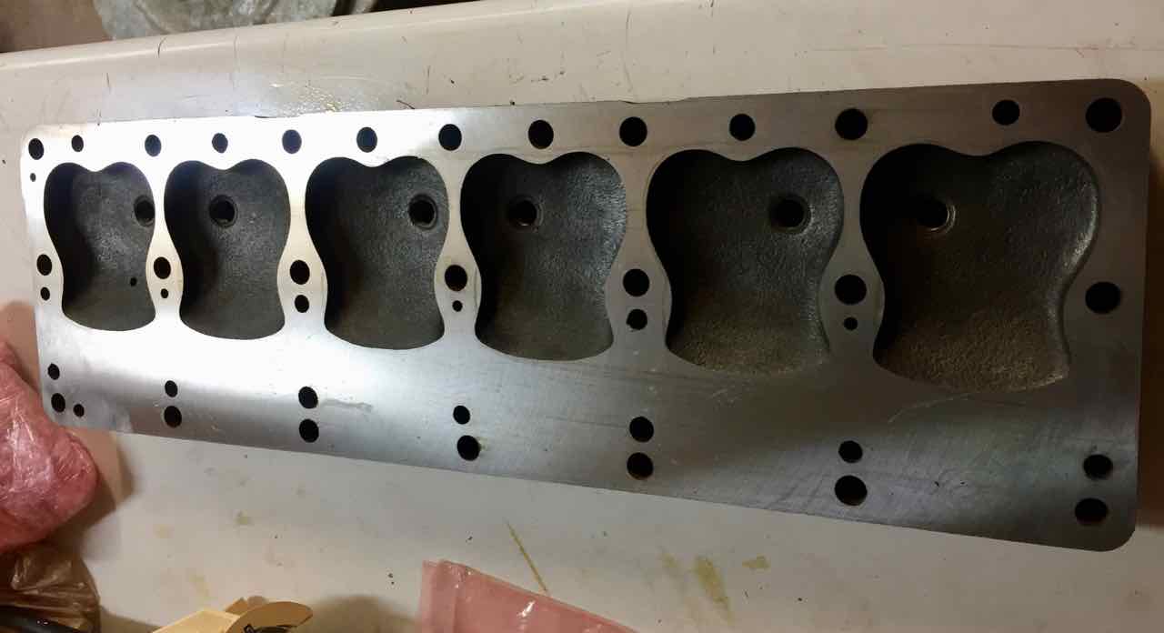

Ashyers, do you recall the amount that you milled on the head to achieve the 80cc? Any special head gasket used?ashyers wrote:Looks like things are coming along nicely. FYI the Sealed Power pistons have .020" less compression height then stock. If you're milling the head and care to do some measuring raising the compression is free power and MPG. The chambers on my current motor are 80cc and yield 8:1.
- M37 head (1).jpg (42.29 KiB) Viewed 3224 times

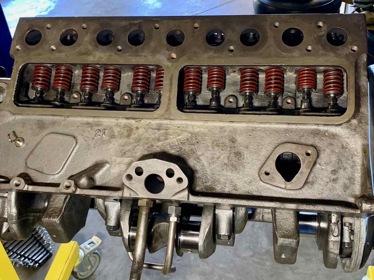

Dusted off the Snap-on valve spring compressor. Installed the valves, springs, locks.
- 230 valves installed (1).jpg (142.06 KiB) Viewed 3224 times

One thing to consider is that you will gain back a little of that lost compression from the over size on the bore. That may be why they dropped the top down to keep the compression stock. I don't have all the parameters to do the math on that engine.
