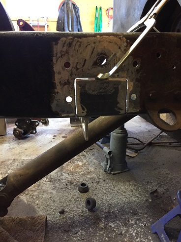

The rusted out crossmember behind the transfer case was cut out, new metal was welded in, and then it was bolted back into the frame and welded back along the top like originally found. It was a tough job as a lot of the metal was 1/8 inch which I didn’t find easy to form by hand, but I eventually got it all done, as well as repaired the lower flange of the frame where water has collected and rusted it paper thin. Since this is right where the spring hangers are located, I did not want to leave any weak spots and so had some 1/4” steel bent up, which was then welded in place. New grade 8 flange bolts were used to put everything back together. I researched using rivets, but in the end I couldn’t justify it, and instead went with bolts which will do just fine.

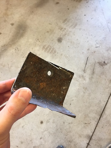

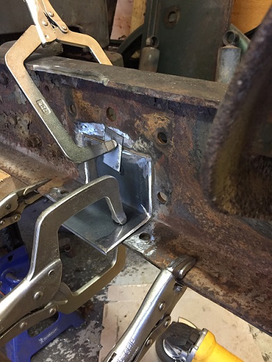

Here are a few pictures of the repairs
Cutting out the thin piece New piece ready to be welded in

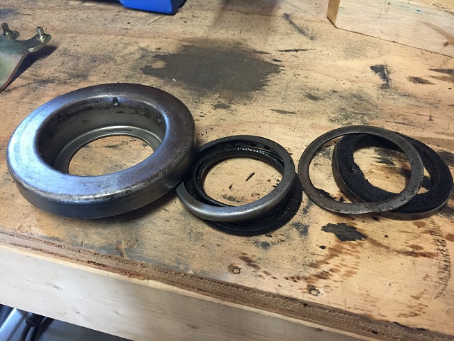

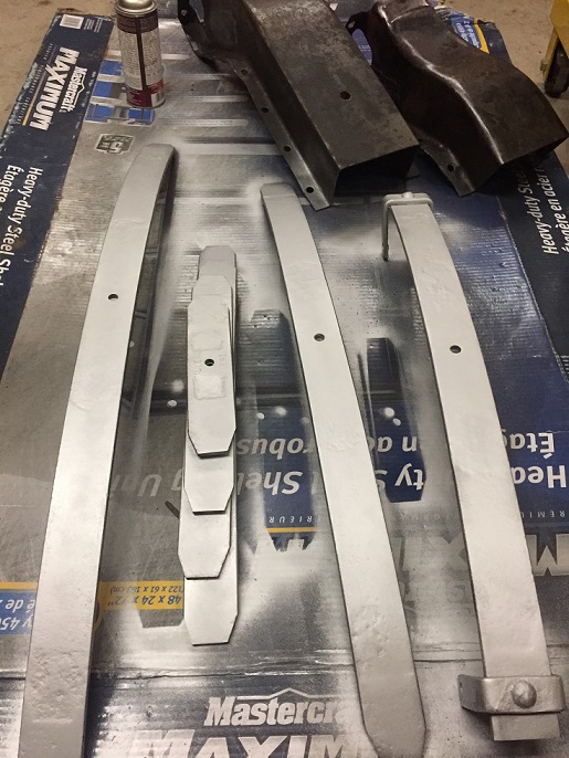

a couple more..
Springs being cleaned and painted with zinc primer Breaking down the old pinion seal The new seal went inside the outer carrier, after it had been smoothed and cleaned up

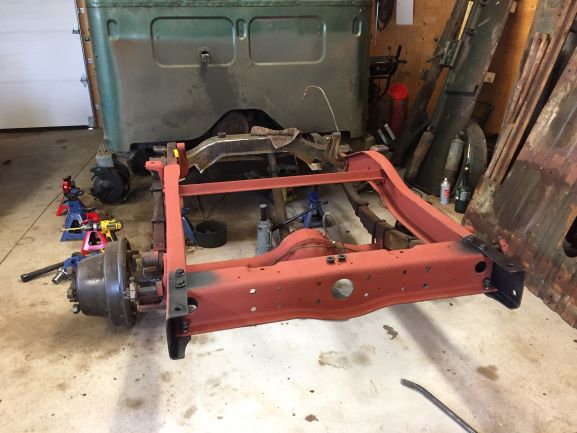

Ok, crossmember work is just about done. Just have to finish painting the lower portion, and then bolt it in.
In the meantime, I’ve started to put the springs back on the rear. I had to look up how they install, as the second leaf has a curl that goes towards the front. In order to install them I found it was easiest to install the front pin, then lift the spring and support it with a jack stand. Then with a little downward pressure it was able to fit. Otherwise the spring was a shade too short without a bit of pressure to extend it.

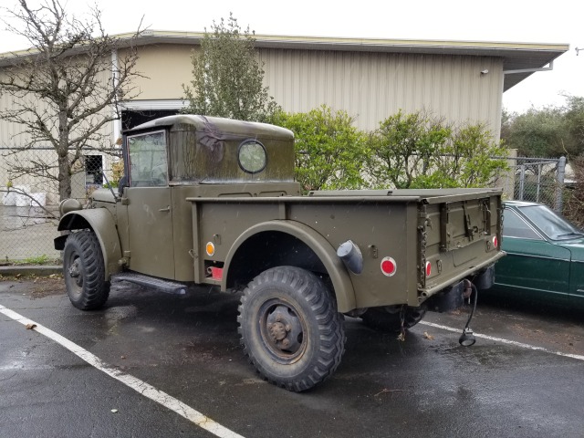

Hi guys, been a while since I last posted anything about the truck, but I’m still here. Took about a year off working on it to finish my M38 and get it roadworthy, although I did find time here and there to do work on the M37 while I was waiting for parts etc for the Jeep.
In any case, here’s a little update as to where things have gone over the past couple years. Here are two pictures of the M38CDN, built by Ford in Windsor, Ontario. Let me just say I have had a blast driving it around these last few weeks! It took roughly a year of work to get it on the road as it was already mostly restored about 10 years ago but never finished. I had to redo a fair amount of work that I had done when I was younger and much less experienced, but this was to be expected as this was the Jeep that kicked off my interest in military vehicles.

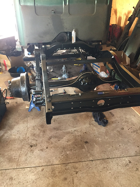

The truck has come a fair ways as well. When I last left off on here it was a bare frame in the back.
The rear axle was cleaned up, painted and put back. I did not touch the differential except to replace the front pinion seal which was a leaker. I tried being clever with a modern seal inside the old metal pinion seal shell, but I couldn’t make it work right so I eventually went with a neoprene seal of the older design. Seems to be doing just fine at the moment, but we will see once the truck starts moving.

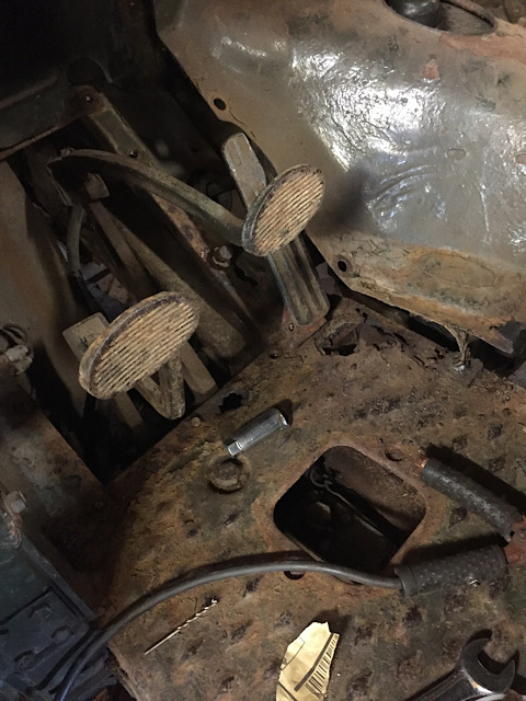

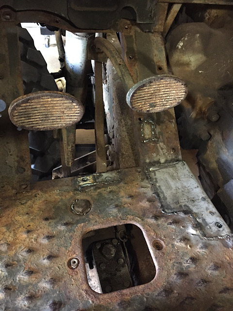

After this I took a break and worked on the floor of the cab which had some rust around the gas pedal. It turned out the pedal hinge was a door hinge bolted to the floor on a stack of washers, so that was all tossed and I replaced the hinge with a spare takeoff I had acquired some time ago. After a little cutting and welding…
