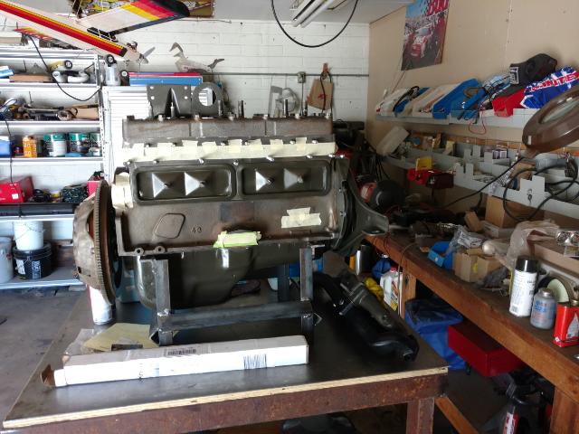

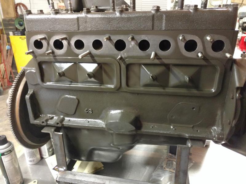

After a few non engine setbacks, I finally got the engine back to my garage from the shop. Final assembly of the external bits is all that's left. (And painting)
Re: Just another engine build thread. Sort of.
I don't believe in painting the gasket surfaces, so they were masked. Peeling off the masking after painting the cam side.
agree with that, I too masked my mating surfaces to avoid paint on any gasket surfaces. And was so fearful of dropping this or that into one of the block openings, that masked them too. But then I managed to drop a test fastener down into my big generator, necessitating removing it to shake out the bolt, and am still laid up pretty much just lying in bed with my back pain. So I then wrapped the generator in plastic wrap. If I had done so before, I would have my motor all ready to go back in my truck. As it is, I am driving out to Nebraska in two days for several weeks. A little forethought would have made life a lot better for me right now. It would be disheartening to have to take a sump off to retrieve a washer or bolt.
