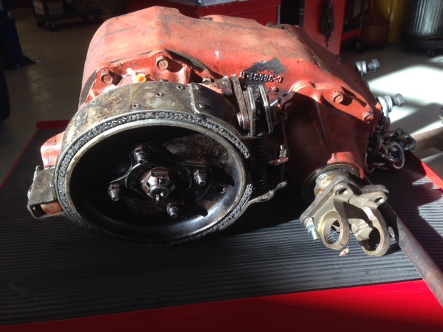

Are those cracks or just surface imperfections? Might be wise to clean up the area (wire wheel or media blast) and check with at least a dye detection kit. If that brake drum is actually cracked, even on just one side, I wouldn't use it.

There is a good possibility the cracks do go all the way through. Hard to see until the drum is sandblasted, then cracks typically shine out. This is a cast piece, because of the type of material, it is extremely hard to perform a successful crack repair. Usual outcome results in the drum cracking completely in pieces when heated for repair. New NOS drums don't exist as far as we can find. We have successfully fabricated, machined, and balanced new drums that fit and perform better than the originals, and they don't crack due to heat stress. We have drums in stock.
Re: Ins & Outs of Transfer Case Rebuilds
There are definitely small cracks that can be seen, - another part to buy!

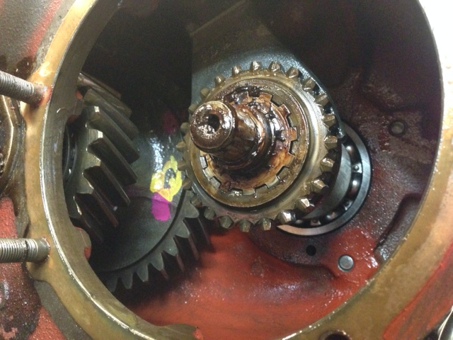

The clay like material you see was gearlube. It was about 1/8" deep and filled the entire idler gear. The amazing thing is the bearings didn't look too bad and had no signs of heat damage. The gear teeth looked OK other than some signs of moisture damage.

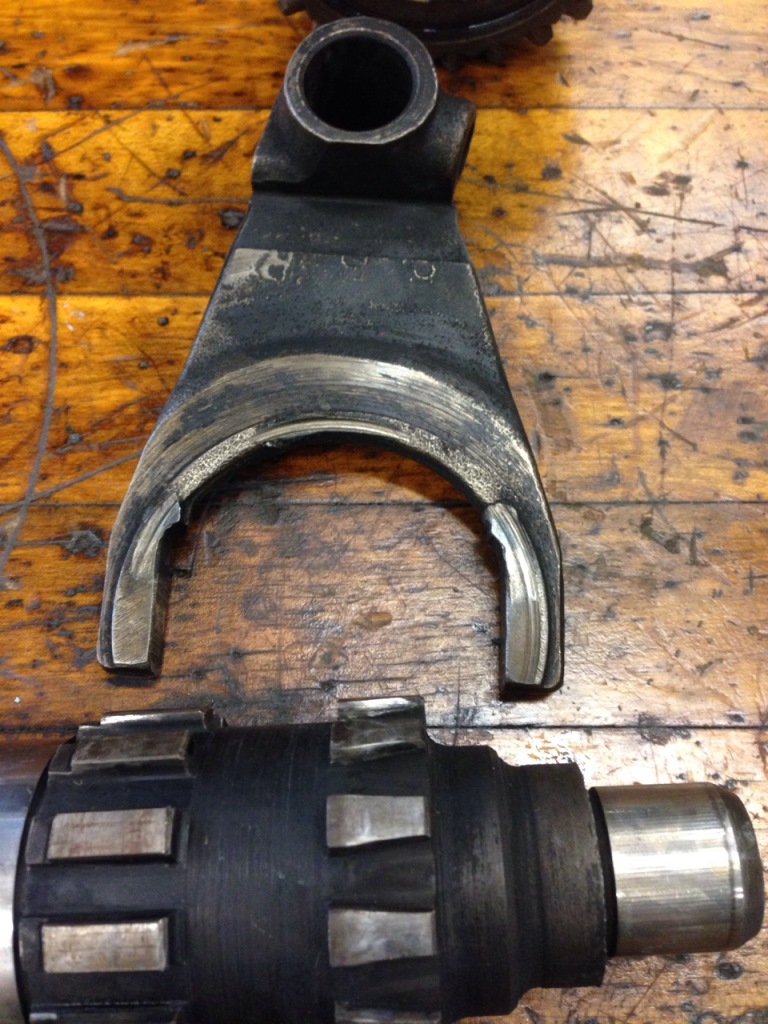

On the shaft you can see the wear on the short trapezoidal splines. This is where a fair amount of the backlash I was seeing came from. The fork had some pretty significant damage. Looks like it was preloaded into the clutch at some point and fried.

Those cracks are kind of scary. I'll have to check our drum, but I think it's fine. That would make a hell of a Frisbee!

Being advertised as NOS isn't a guarantee of serviceability inside. If it was stored improperly (NOS would mean it's been sitting around for some 50 years now, perhaps in unheated warehouses), it could still have plenty of corrosion on the gear teeth and bearings.
The TM on rebuilding these things instructs to drain the lube for storage, so even the lower areas wouldn't have had much protective oil on them.
Not long ago, I unwrapped an NOS idler gear for the NP200. It was still in the original box and the oil paper wrapping. Yep, it was unused, but it had pitting on some of the teeth. :cry:

Elwood is exactly right with the possible condition of NOS components and individual parts. We've used the phrase that today's NOS stuff is like the old gray mare, "ain't what they used to be." As time goes on, it takes a toll. Storage conditions and care during storage is everything, and not much concern in the eyes of some vendors who see only $$$ signs from buyer's who drool when "NOS" is in the description. It is most definitely "BUYER BEWARE."
Viewing the pictures posted above, in many cases the forks are repairable, we have built up and resurfaced many. Can't see the kind of detail in this picture needed to make a smart determination. The shaft splines don't look that bad in the photo, of course pictures are very deceptive because you can't see nearly enough detail. The splines still have the correct shape in general, a new shaft will look exactly the same. Again can't see enough detail in the picture to make a determination of serviceability.

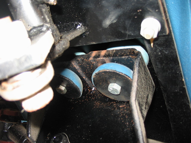

I did have a question regarding the mounting bushings. The ones in the truck are in surprisingly good shape as far as cracks/rot. I'm wondering if they have taken a set and are compressed a bit. When the bushings/stand off assemblies are tight how much compression should the bushings have (how tightly should they grab the mounting brackets). My sense is they should have zero float, but I'm not sure if they should be clamped tight either.

If my memory is working this morning, those rubber isolators should be solidly compressed when installed. There's no torque spec on the through bolts, but that transfer case shouldn't be moving around.

Isolators should have a solid crush, this procedure is actually built into the assembly so you can't do it wrong. You should have 4 pieces that look like tubes with a big washer attached to one end, isolators slide over the tube. The length of the tube controls the rubber isolation crush as the bolt is torqued. When the end of the tube contacts the cross member, you begin to feel resistance quickly as you tighten the nut. The length of the tube prevents over or under crushing of the isolators, IF the isolators are in good condition. Torque the bolt to the required spec., you should then be able to visually inspect the rubber for correct crush.
Charles, do you have any known options for replacement rubber isolators other than oem (50 years old) items?

I think Chris Case over on the Power Wagon forum was making them out of new materials? You might check there.
Here is a link to his photo album showing a set he made out of blue urethane...
http://imageevent.com/bigchriscase/bodymountsurethane

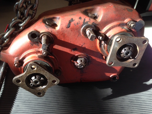

Here's some photos of the NOS case I picked up:
The M37 Flanges are on loose for shipping. All of the seals are double lip rubber seals, not leather. The case had M715 style yokes.
NOS Frt.JPG (130.94 KiB) Viewed 2684 times
Now I know how thick the asbestos is supposed to be! Picked up a new flange for the D-shaft too, the current one lost it's press on the bearing cups and they were walking a bit.
NOS Rear.JPG (114.88 KiB) Viewed 2684 times
We'll be tearing down the case to remove the grease that's on the needle bearings. It's become a bit like glue from age. The good news it from what I can see the gears and bearings look nice and new inside. I'm amazed that I could still purchase one of these!
